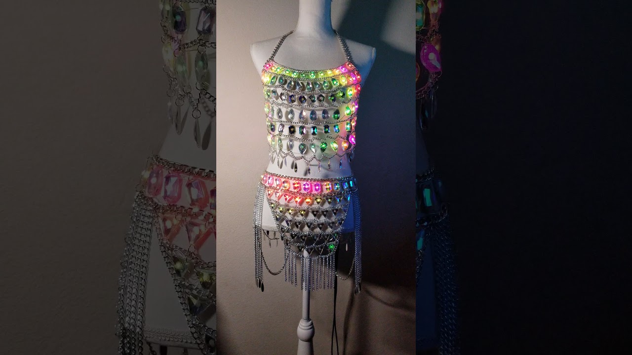

Video for @jeff
[![](https://img.youtube.com/vi/WuVvQGpQv-Q/maxresdefault.jpg "mapped") ](https://www.youtube.com/watch?v=WuVvQGpQv-Q)
@wizard I haven’t tried AP Mode without firestorm but def want that option so just updated to 3.16 and will report back soonish (life permitting)

Nice!!! Amazing! I still can’t get over thinking about how much work goes into wiring something like this up.
<div class="post-metadata">
**Author:** ![Sunandmooncouture](https://forum.electromage.com/letter_avatar_proxy/v4/letter/s/e56c9b/32.png) [@Sunandmooncouture](https://forum.electromage.com/u/Sunandmooncouture)\
**Post date:** [April 24, 2021, 6:44pm UTC](https://forum.electromage.com/t/mapping-led-bikini/1156/12 "2021-04-24T18:44:54Z")
</div>
Yeah while showing how it’s made I said something like I trust you wont steal my design and their response was no one in their right mind would put that much work into one piece. Boom built in patent protection
