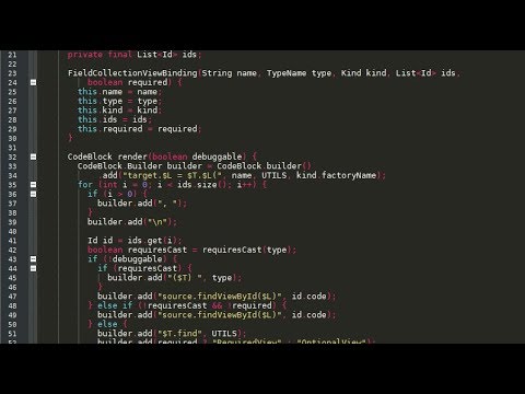

Also, is the following tutorial the norm, or are there really decent places to learn?
Do people use things like skillshare, etc?
Aiming for the 3D render is somewhat ambitious when you’re still learning to code!
Do you learn best by tinkering, video, or reading?
If tinkering, play with the included “An Intro to Pixelblaze Code” pattern. If video could be something like this, and reading is a good fit for the recommended subset of Codecademy JavaScript.

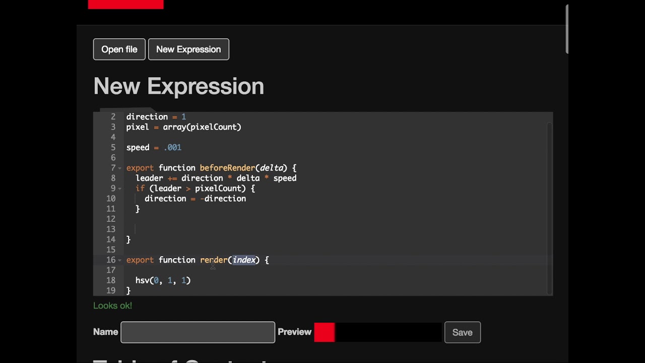

Have you seen Writing Your First Pattern?
I’d then also recommend my programming KITT video, if only so that you can give me critical feedback on a scale of 10 - “ooh I get it” to 0 - “this is just like Every Programming Tutorial” and I’ll know I’ve fallen in the same trap as many other developers that try making tutorials :laughing:

BTW @wizard your KITT pattern video is hugely helpful! I’d watched it a few times before I even got the PB and a couple more again after your request, and I have to say that you and Jeff are excellent at describing what you’re doing.
If I find a chance, I’ll give you a more detailed analysis of what I remember being one or two spots where I just had to have faith that what you were typing would work.
Between your Kitt video and @jeff’s, where he gives a description of the wave timings and their use, I’m sure I’ll have another couple hundred views before I don’t need to return to the video each time I want to use something from it.
