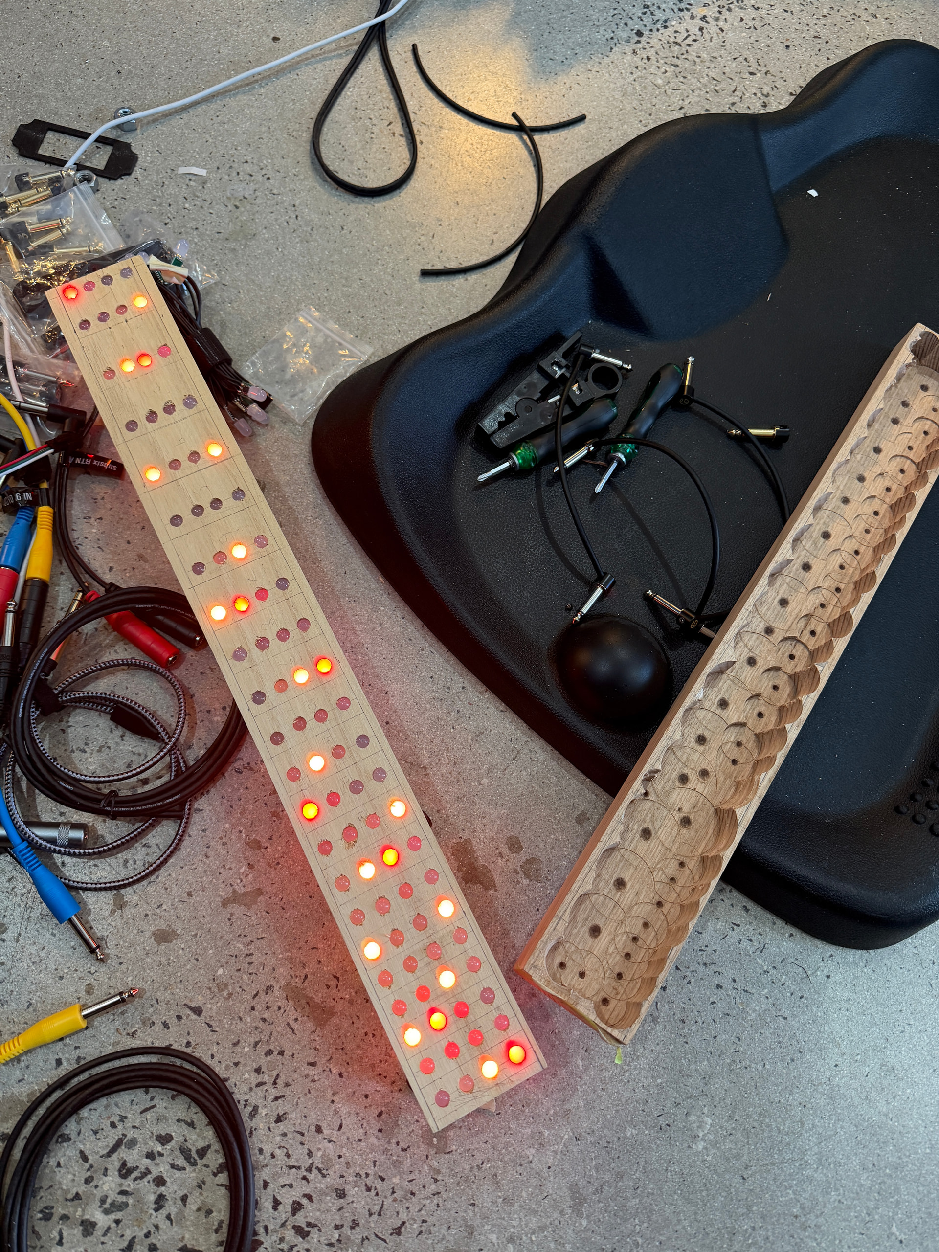

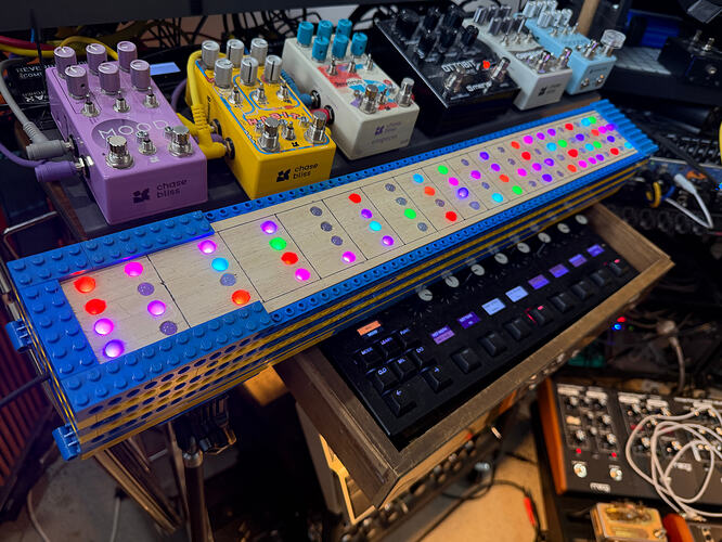

A new musical project - the 'fret and forget' system
Following on from my piano key scale finder project, I’ve been working on something to help me remember my bass frets.
This project uses a string of addressable LEDs, and can be configured to zig-zag up and down the strings or across the fretboard.
The string tuning can be specified, along with:
  • scale mode (colour root and scale notes separarely)
  • interval mode (colour/bright root note and intervals from it differently)
  • note mode (colour notes in scale to a pre-defined colour language - I use the colour of the fretboard stickers I have been using)
There is a huge range of scales available.
This was put together with a lot of assistance from Claude Code. Any optimisations welcome, as would be an adaptation to guitar if it interests anyone.

Looks amazing! Great use of Lego :smiling_face:
Verrry impressive project! All of the skills required to pull this together; inventor, electrician, woodworker, coder and musician, very rarely exist in the same person. And what a perfect application for Pixelblaze.
On a side note, as a lifelong music lover I had no idea there were so many scales. I’ve recently been listening to a duo called Angine de Poitrine. The guitarist/bassist has a custom built doubleneck guitar/bass that is double-fretted so he can play their music which is performed in 24tet. The reason I mention this is that several of the reaction videos have mentioned the scales that the songs were written in. And before I went down a rabbithole of Persian, Indian, and strangely, Balkan polka-style with occaisional forays into full on math/shred rock, I had NO idea we had so much scale -age to build music on!
Sorry for rambling, but your scale selection comments and the photo with your Chase Bliss loopers reminded me of my new favorite band.
Awesome work and thanks for posting this! :musical_notes::tada:
Some very kind words there, thanks! (though to correct the record, this became a lot more achievable when I found pre-wired LED strings!) I’ve now got it mounted up with a proper frame around it with fret markers, so I think I am ‘done’ for now. Might consider a plastic print case in the future.
RE: A-d-P. Like a lot of prog/math bands, I respect them, and am amazed by them, but actually struggle to really get into the microtonal stuff. If that’s what you’re into, King Gizzard and the Lizard Wizard do a bit of that - they even have an album called Flying Microtonal Banana!
You might also like this lego microtonal guitar: https://www.youtube.com/watch?v=rPCEImSfCwc
