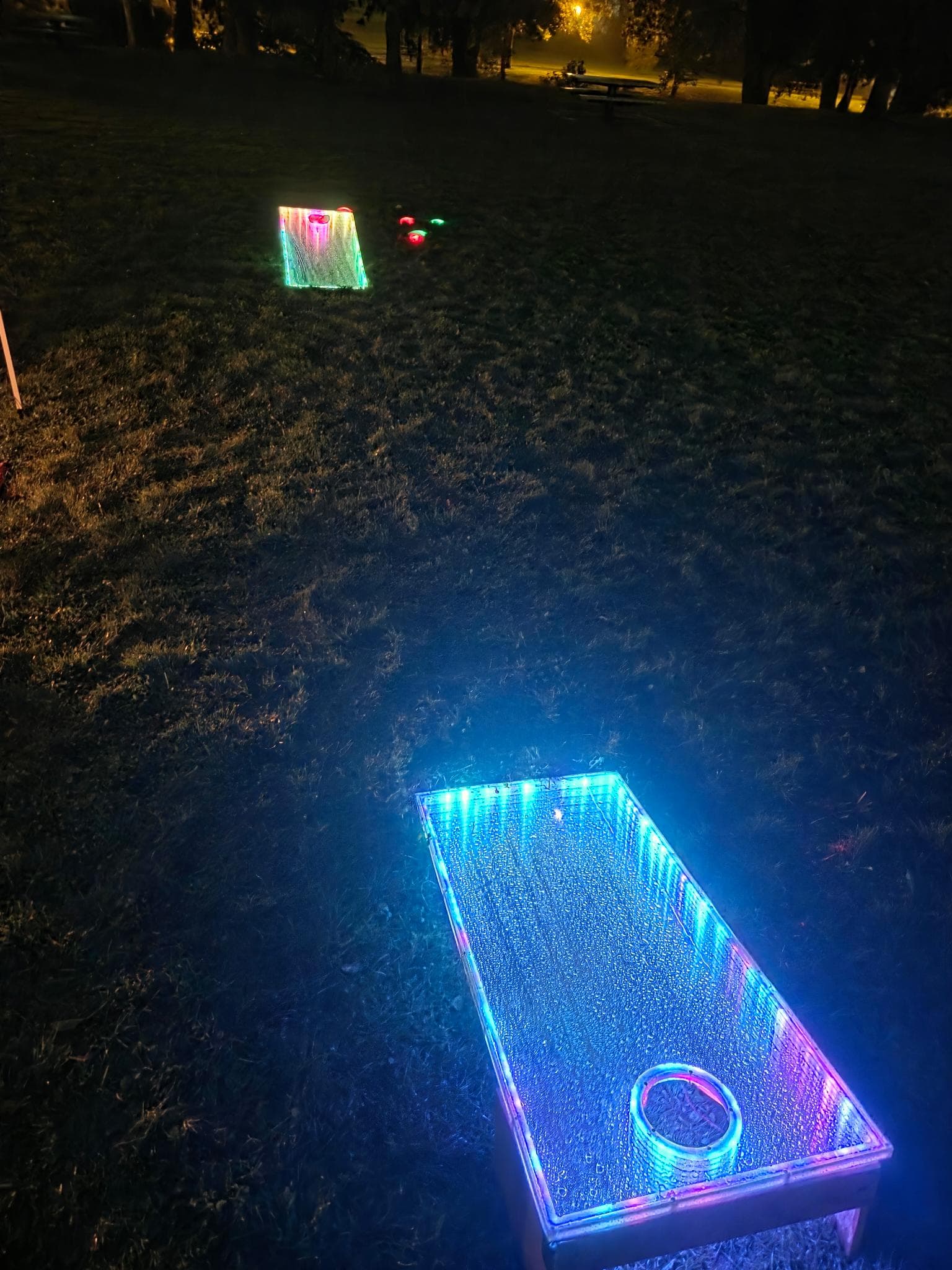

For example, I’m working on this cornhole project:

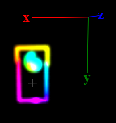

And in addition to the X and Y coordinates of each pixel, I want to know if that pixel is in the ring and what clock position in the ring it is. I also accidentally mixed LEDs with different RGB order, so I need to track which pixels need to be corrected in software. All this meta information is stored in the Z coordinate, so I get this weird generated map:
It works, but it’s pretty hacky and difficult to parse out several different attributes from one numerical value that has been normalized between 0 and 1.
