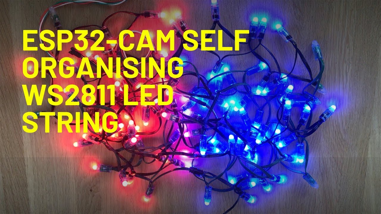

Getting closer:
This is a ESP32 cam based solution, which is neat..
but it looks like this next guy used some of this code, and made it better:
