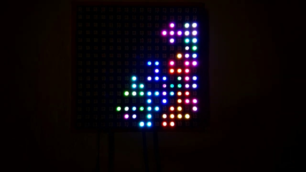

Video of a 32x32 RGB LED matrix (SmartMatrix) implementation:

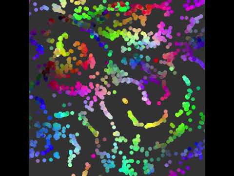

So one of the first things I tried was building a variant of the “boids model” in which boids are very strongly attracted to others of similar color and do their best to avoid differently colored boids.
It actually works pretty well except that, sadly, it takes even more computation than the original exhaustive search approach. So much for aesthetics!

The whole, slightly slow (around a minute to complete) thing in action:
Wow, excellent work! Here it is running on a Fibonacci256:
Super pretty!! Just updated my post w/note on neighborhood size for fibonacci 256, too!
