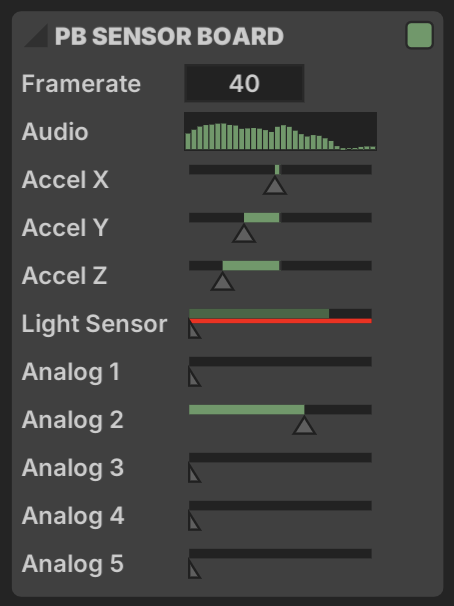

The sensor board has a separate UI section, so it clearly can be used independently of the main section. Could be useful if you want to imitate a sensor board without risking an auto-connect to the first PB found on the network. The FFT uses the global audio adjustments (gain/release/etc) but does an independent value calc to match the frequency bands of the sensor board. It has a frame rate limiter (1-40) and an inline preview of the FFT.
I added UI parameters for the other sensor inputs accel/light/analog. These are mappable in Chromatik so you can route any parameter you want to a PB sensor channel.
If you have time do you mind taking this for a test run? I don’t have a great way to see if these packets are reaching the Pixelblaze correctly. Snapshot jar here.

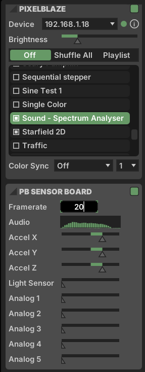

Just tested. UI looks great, and pattern switching on PB is super responsive!
Not seeing any audio data on the PB or UDP packets going from Chromatik → Pixelblaze though. Checked w/spectrum analyzer pattern and w/wireshark. (I’m running the latest released Chomatik - 1.2.1. The plugin says it wants 1.2.2. Would that make a difference for this?)
Edit: Looks like the broadcast packets are going out. The PB just isn’t picking them up. Will look at contents more closely tonight!

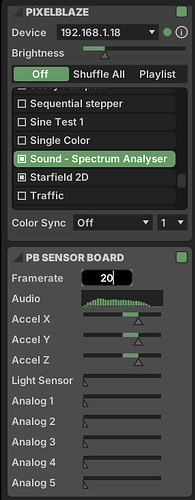

(PB panel screenshot, just to make sure I didn’t miss something in the control setup)
This is all kinds of awesome!
UI looks right: the Enabled button is green to the right of PB SENSOR BOARD which is all it should take. Must be a problem in the packet construction.
Looks like it was just the wrong packet size. Fix on the way…
Should be fixed now. Updated the jar.
Success! That fixed it.
