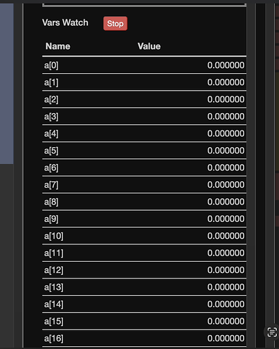

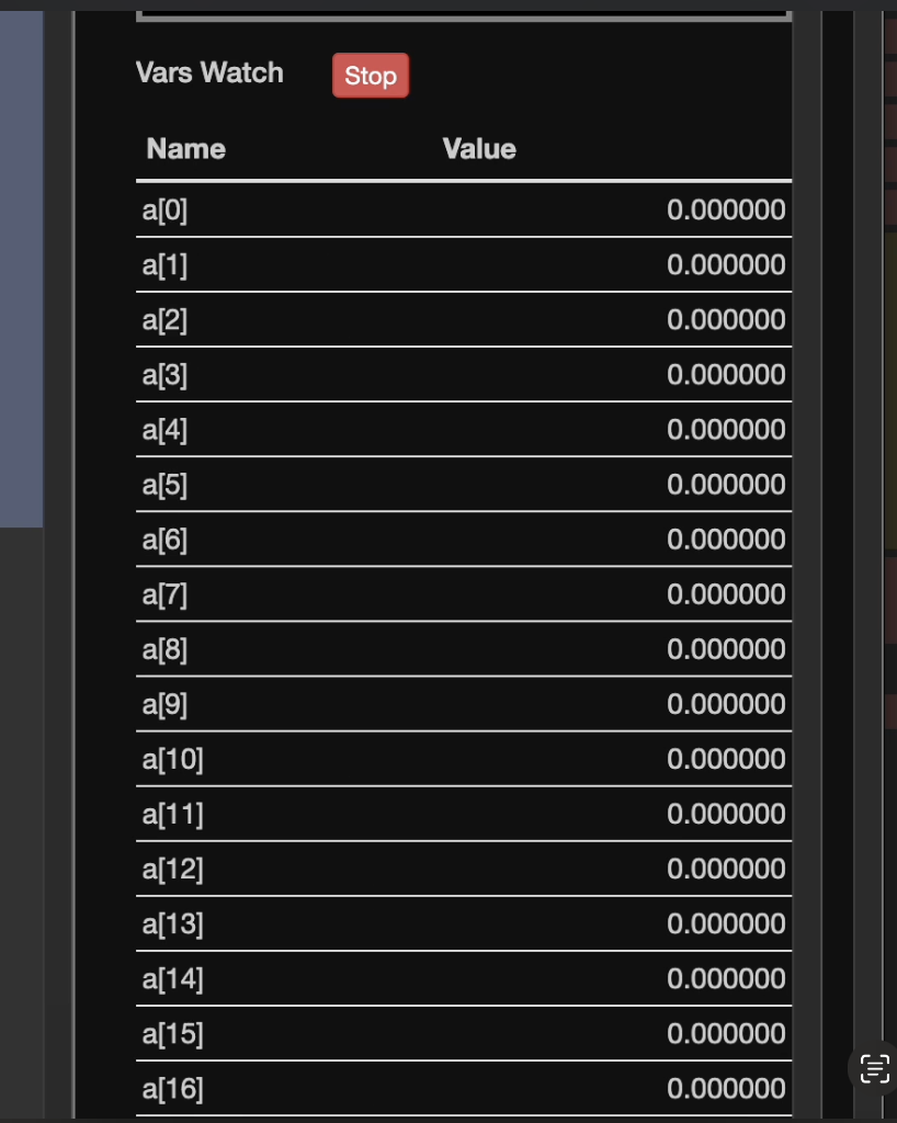

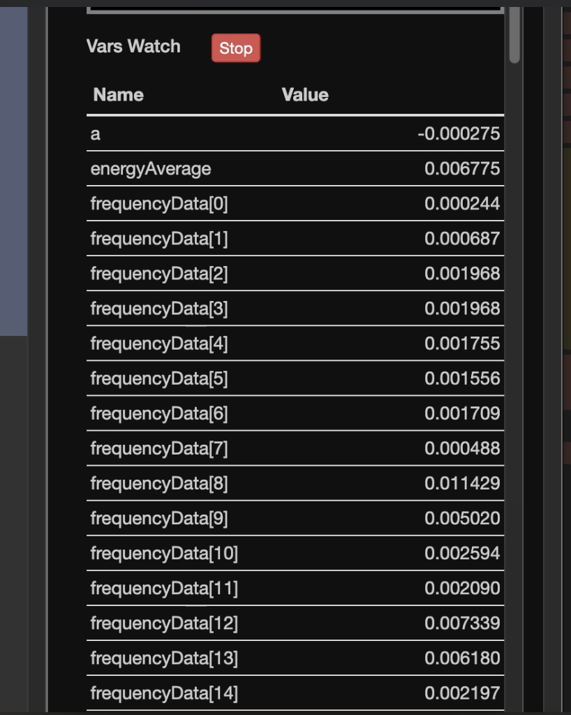

Starting work on an audio reactive animation and wanted to compute the difference between two sets of frequencyData. But in setting this up i noticed that for some weird reason when I compute the difference of two values from the frequencyData array and a past copy of the array, I get an occasional bug where the exported value of the variable flickers into an array!?
Here’s a simple test case, when I run this with some audio running through the sensor boards 3.5mm jack I get occasional flickers in the exported variable list in the ui and you can just about see the a variable gets turned into an array value for like a single frame.

This is normal, a bit of a leftover artifact of how getVars API guesses type. Very small numbers can sometimes be mistaken for arrays. A workaround would be to e.g. add 1 to a and then it will stop glitching the UI, or use a showNumber or gauge UI control to keep an eye on it instead of the Vars Watch.
Ah ok good to know I’m chasing a red herring!
