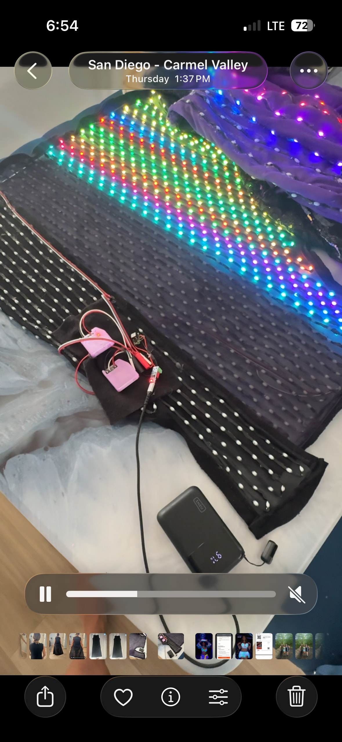

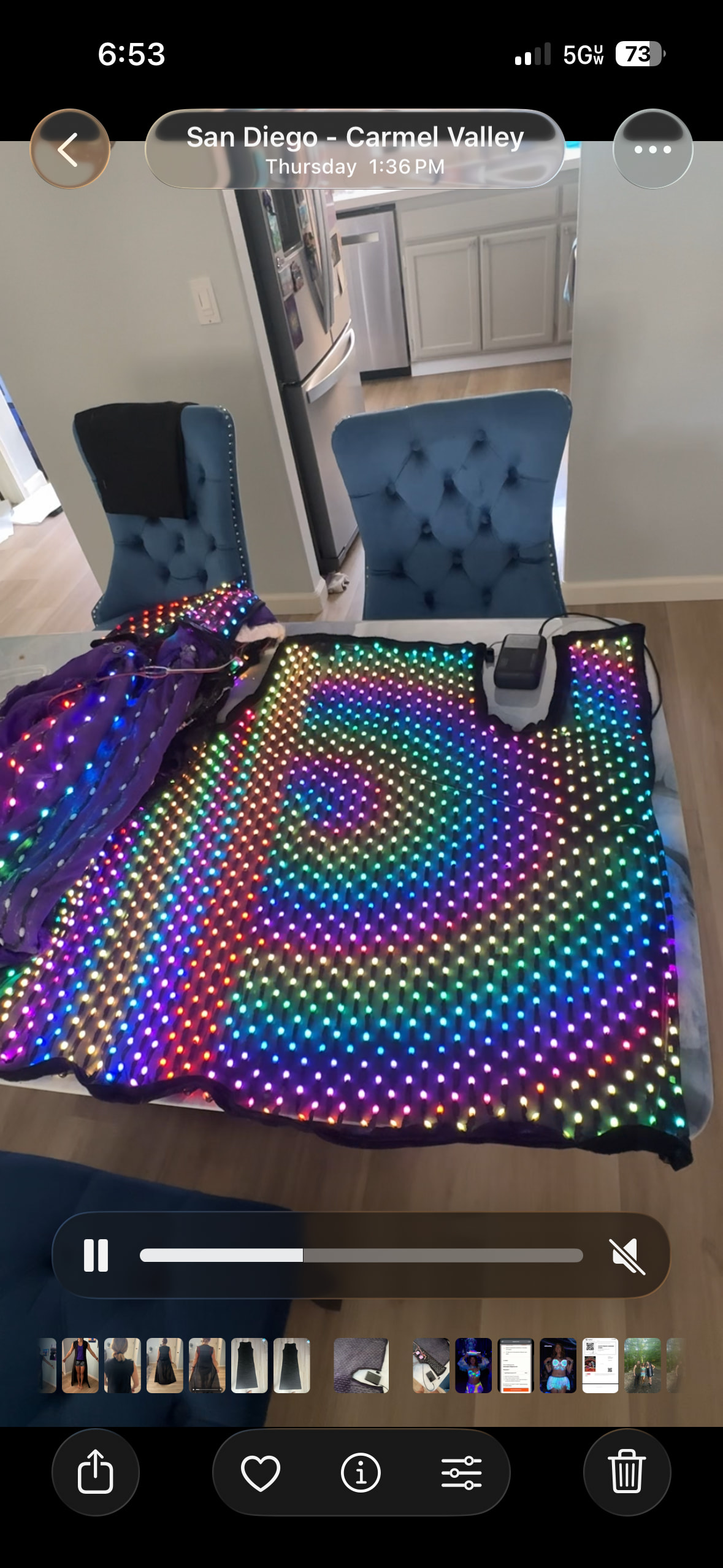

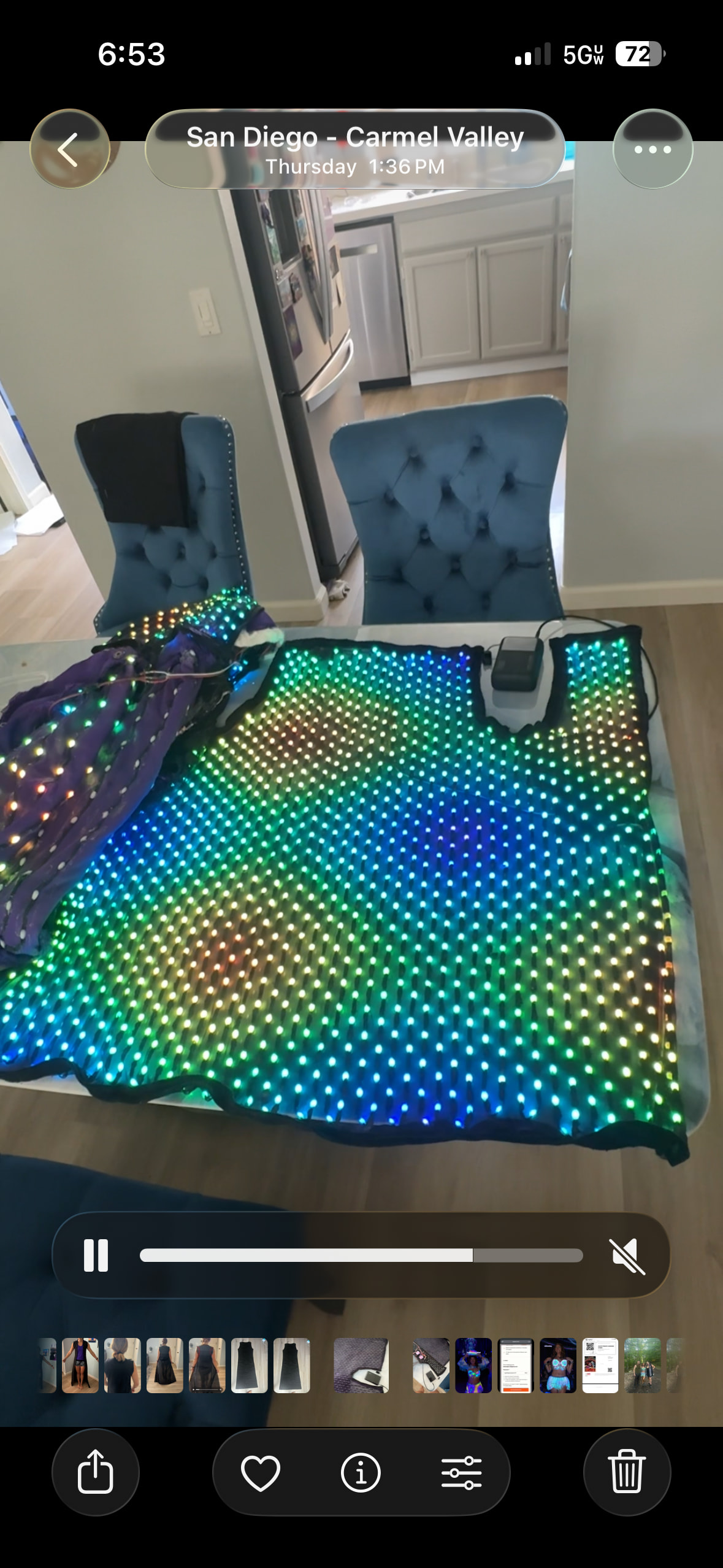

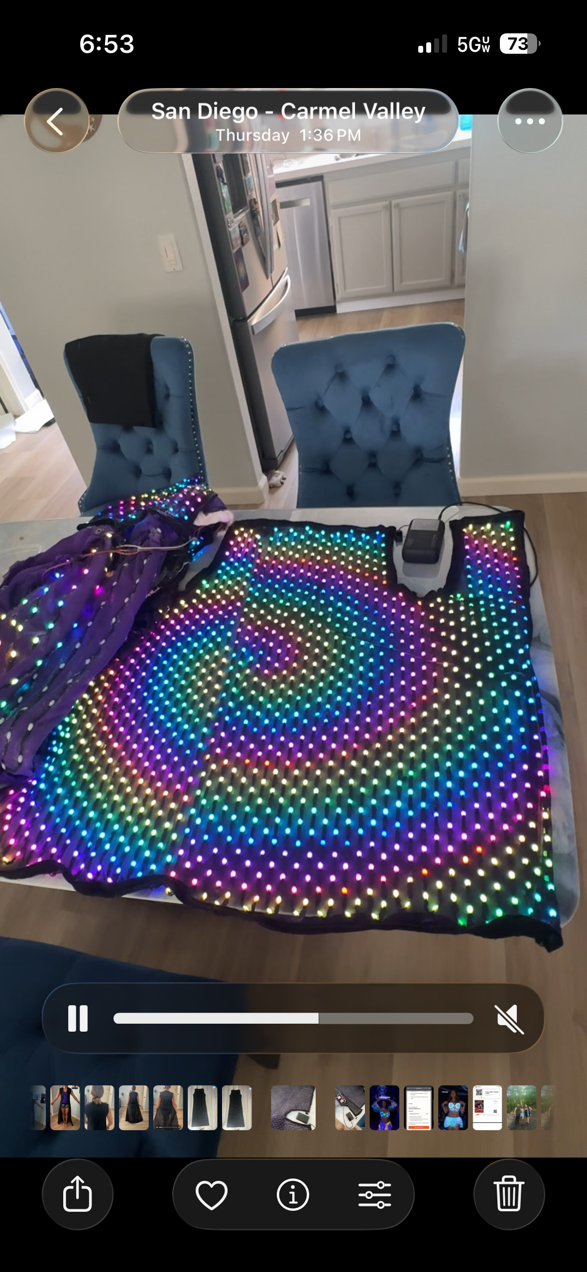

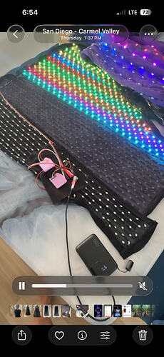

I’ve attached two videos:
  • One showing the LEDs on the follower board starting up before the leader.
  • Another showing the status LEDs on the follower Pixelblaze booting before the leader Pixelblaze.
Edit: I was not able to upload the videos even after compressing the MP4 file. I had to upload screenshots. Let me know if there is a different way to upload the videos.

Once sync initially connects it starts syncing animation time bases, so there might be a jump for the first sync, should be smooth from there. Also some patterns have their own running timers/state that doesn’t use the time based sync, so those only work when the pattern switches at the same time.
