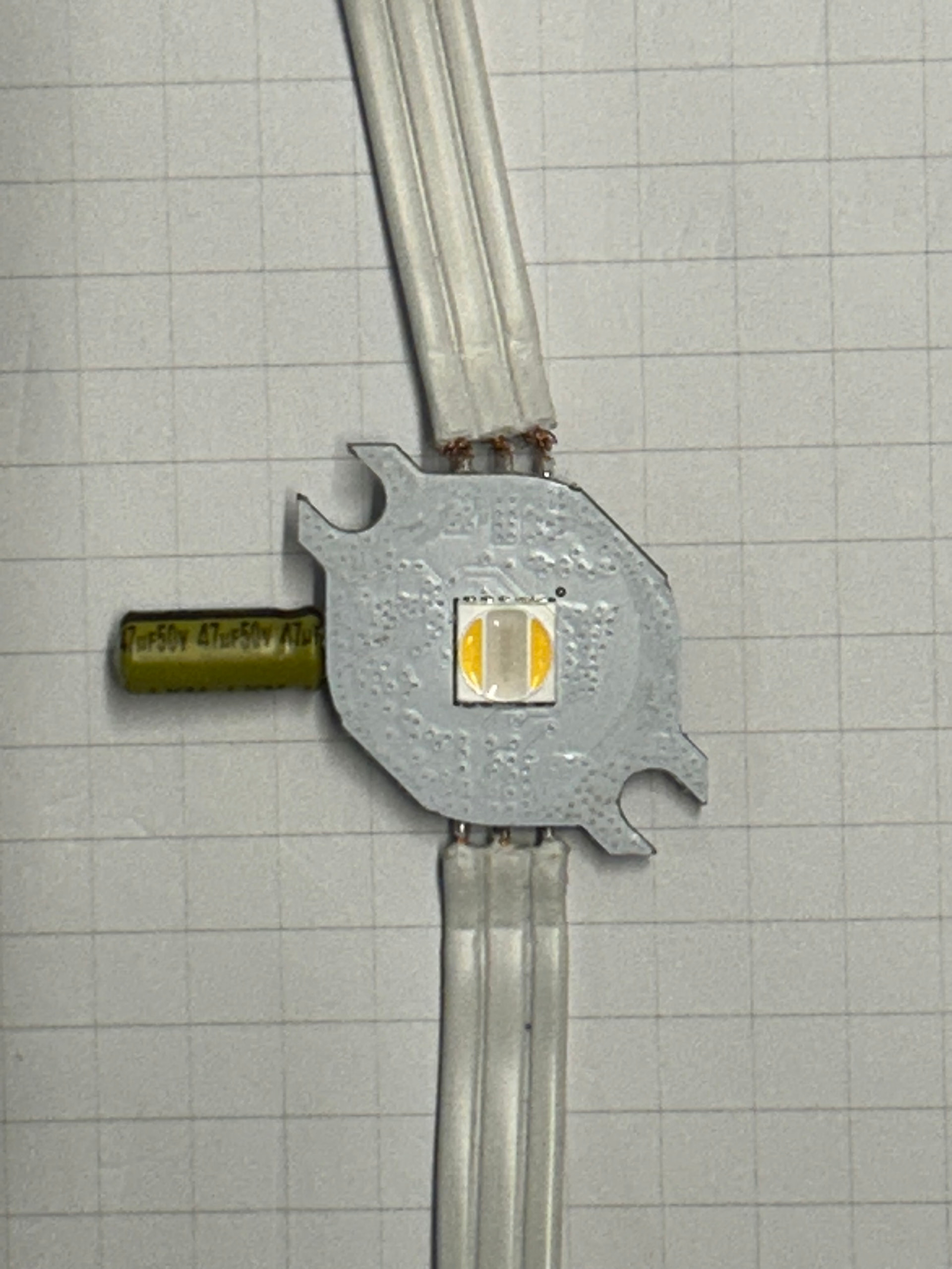

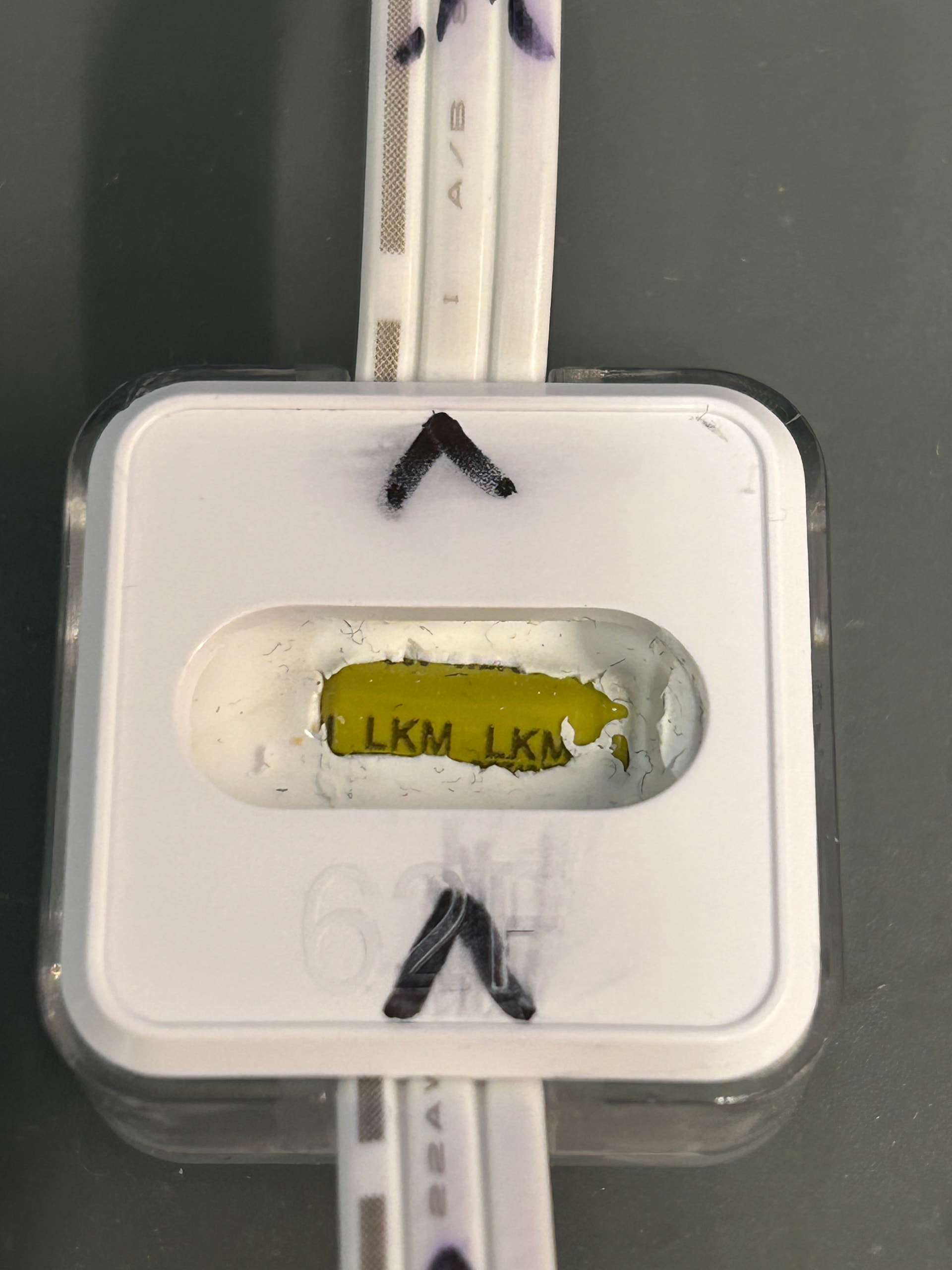

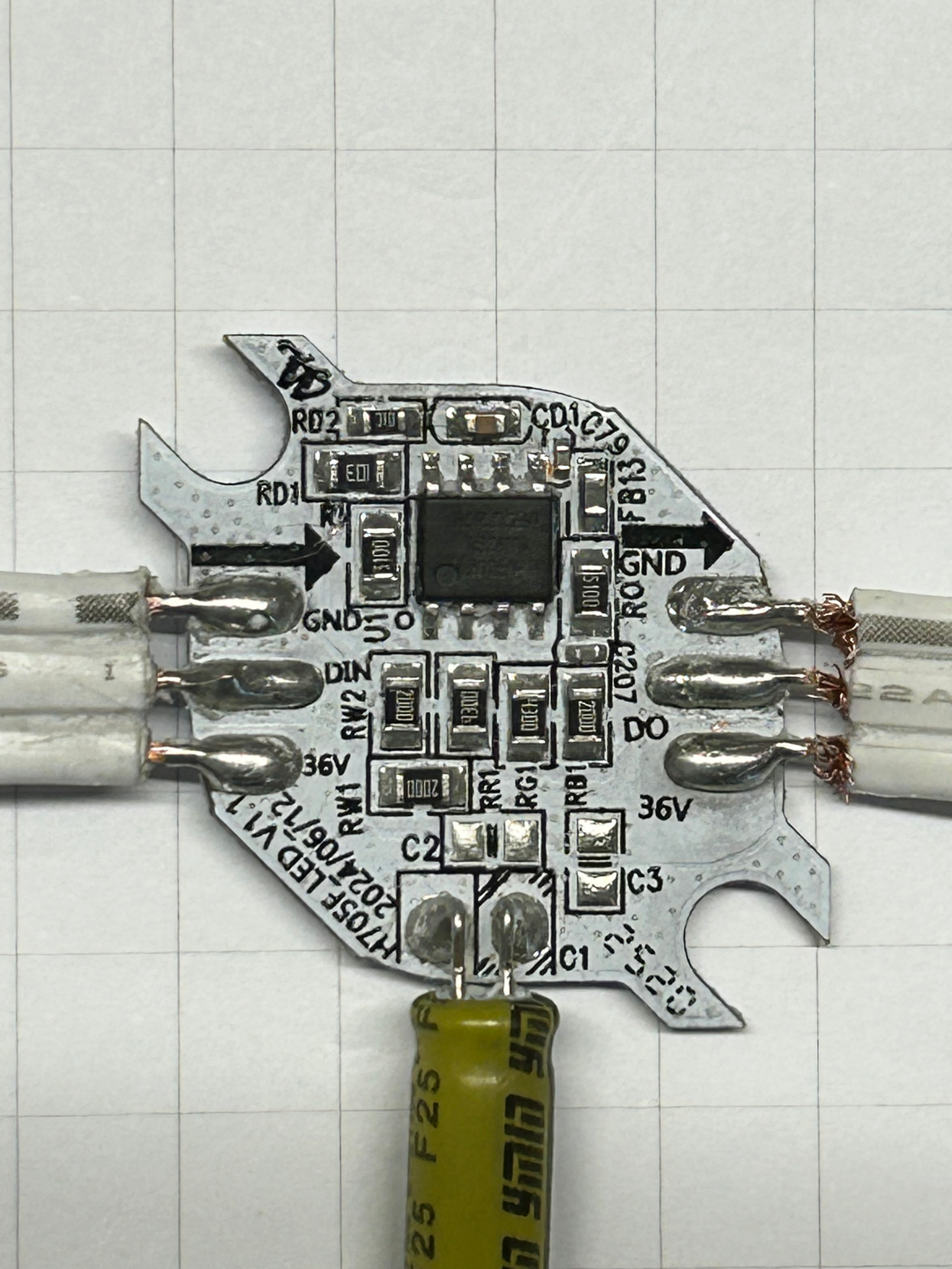

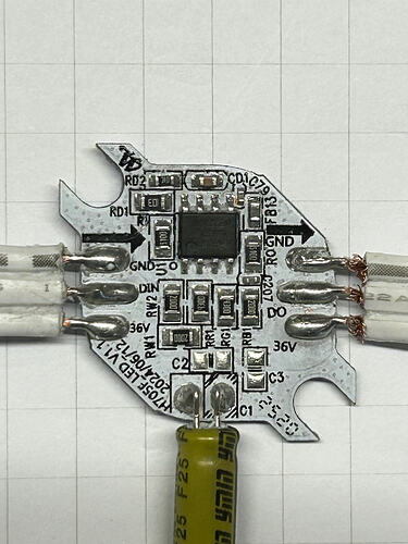

I got some Govee 2 permanent lights to play around with, so I thought I’d share. They work great with the PB, just be careful with the wire order. Dash line = negative, middle with writing = data and blank = positive (36v).

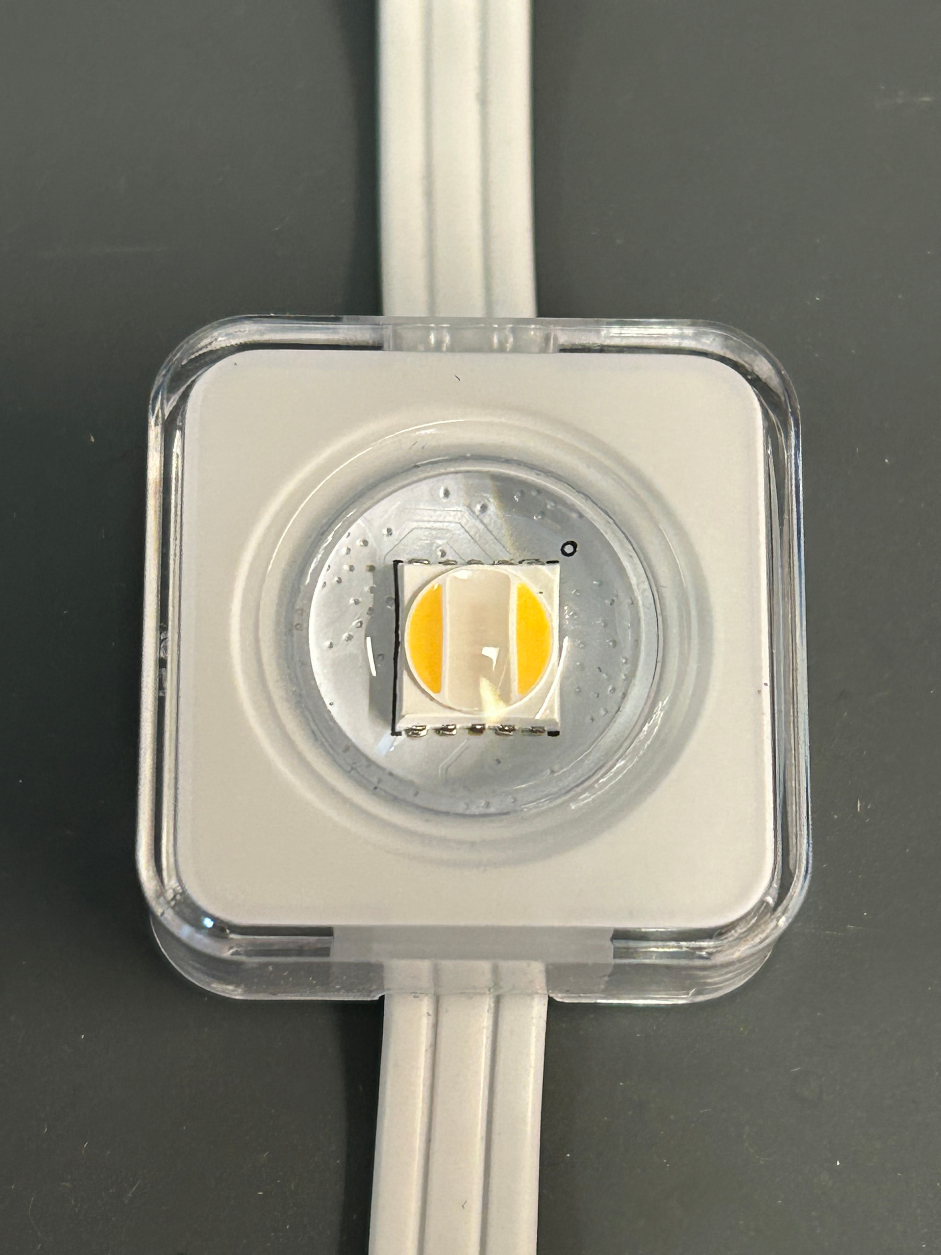

Review - Short Version: Build is pretty good, wire gauge is meh, gigantic cap is very cool, brightness is great, light distribution = cone(neither good or bad), easy to purchase & not very expensive, look good at night.
