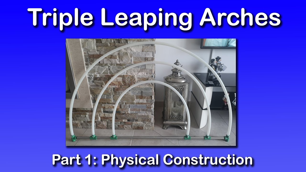

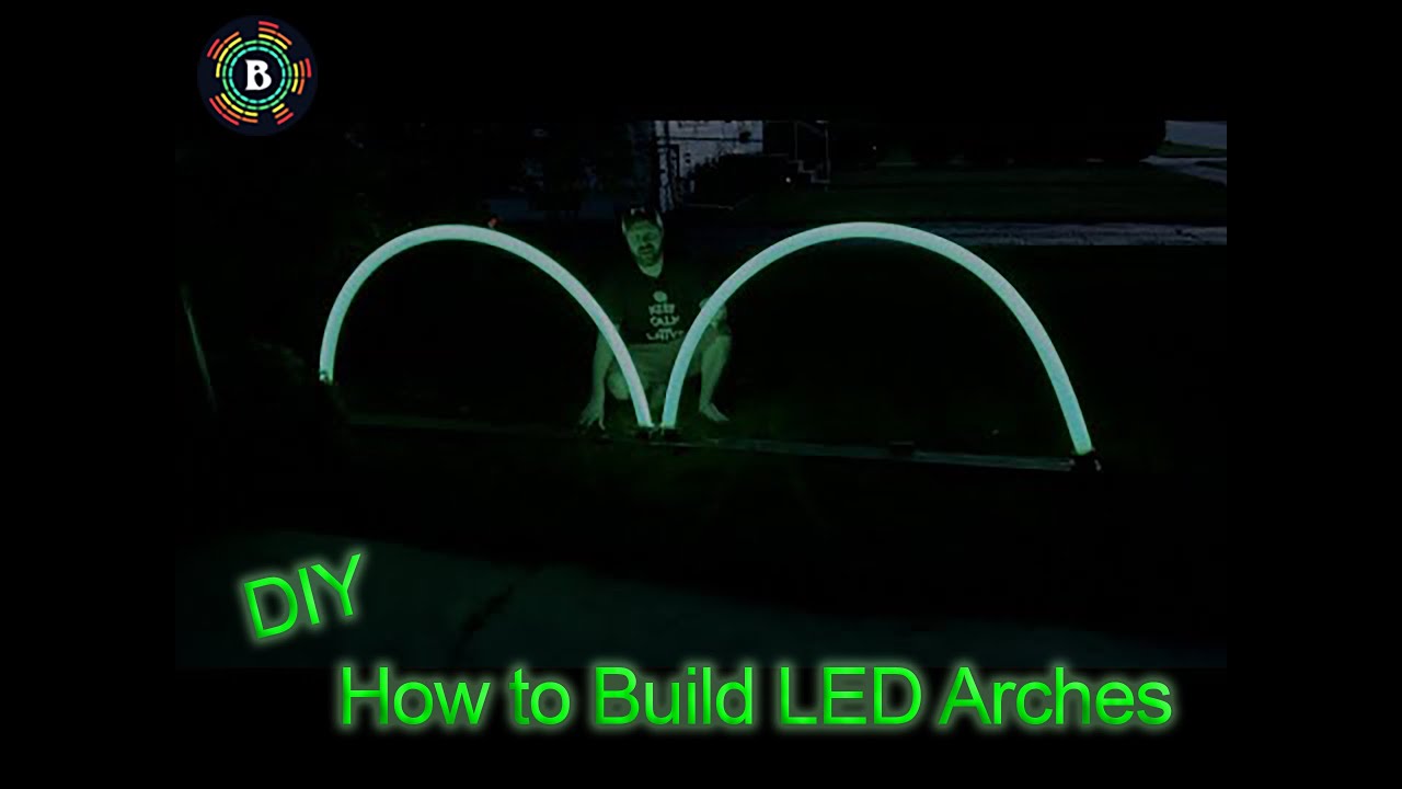

144/m is likely way overkill and a huge power suck. Depending on your needs, 60/m or even 30/m could work… Use white tubing, not transparent for best effect. You can use pex, or other easily available tubing. I’ve seen sone good videos on how to build and wire these… I’ll link when I refind them.
Most of the arch info is for smaller arches so support might be an issue going big, you might need a frame to support the top (or maybe connect one to the next with a cross beam, giving you the stability?)
That’s great info. Thanks for that. I would be using the 5 meter 30 lpm.
