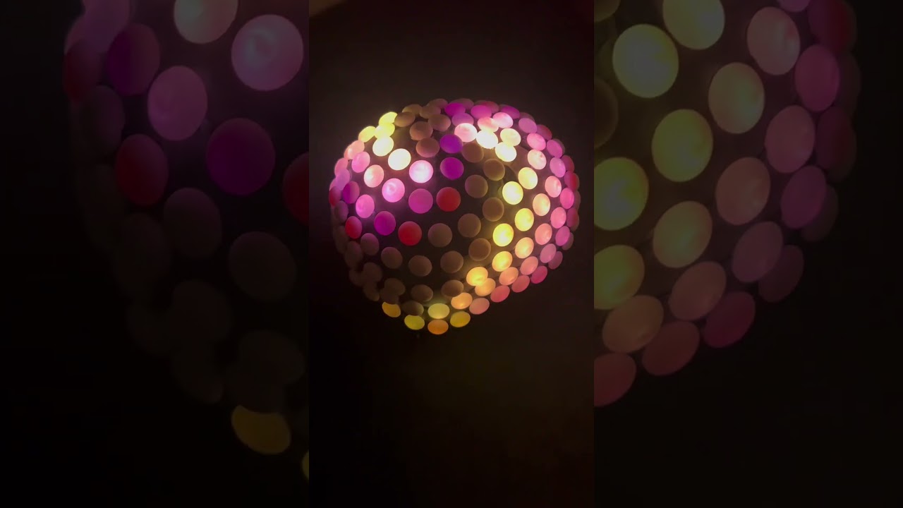

This is my new skateboard helmet, I’ll be wearing it daily – It’d truly brighten my night (pun intended) as piece of playa magic and serendipity if someone saw this post, saw the helmet on the open playa, and came up and said hello.
It uses basically all the techniques I documented a few weeks ago in my beginner tutorial on this forum, but… then gets a lot more complicated when I decided custom design (with help from friends) and 3-D print LED diffusers, which I can share the STL files for if there’s interest – they’re designed to work for the very popular right now pebble string lights, which are used in this project.
The demo footage is using a palette based version of three patterns: Xorcery, Spiral Twirls 2D, and Pulse 2D, with the 3D shape of the helmet simplified to a 2D map.
