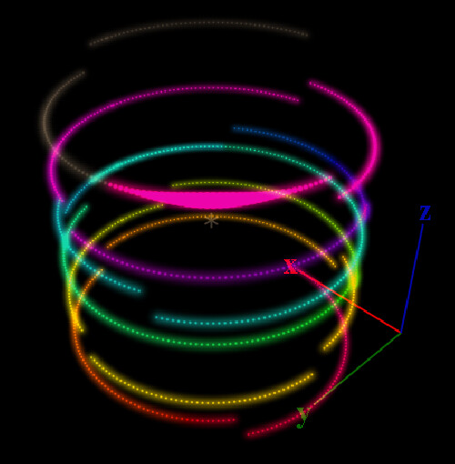

I cannot render 2D patterns on my 3D pixelmap
Hello forum, I am just starting to learn to code in pixelblaze and am having trouble getting any 2D patterns to render with my 3D mapping. It automatically goes to 3D as expected if a 3D render is available, but if only a 2D and 1D render are available it loads the 1D (as seen in the top left corner indicator). If I try a strictly render2D pattern, it does not render.
Could this be because my 3D map points are so erratic? This is what it looks like mapped:
My pixel map consists of manually defined points as follows (pixel map is live):

Try adding a render2D (example below), or updating to this version
You can add a basic render2D that effectively does that:
export function render2D(index, x, y) {
  render3D(index,x,y,0.5)
Looks like that did it! Thanks!
