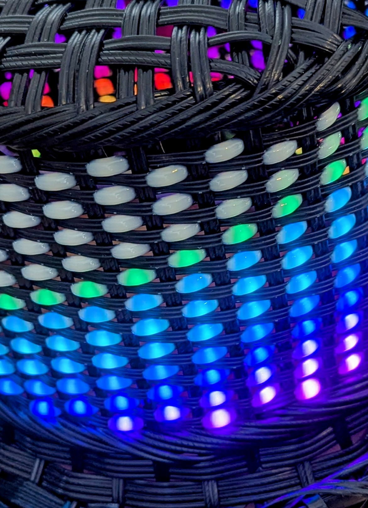

I want to show you my LED hat, which I made out of a pebble strip and poly rattan. Pure braiding, no glue involved. The strip used for weaving has 475 LEDs and a 3 cm spacing. Sensor board is also installed.

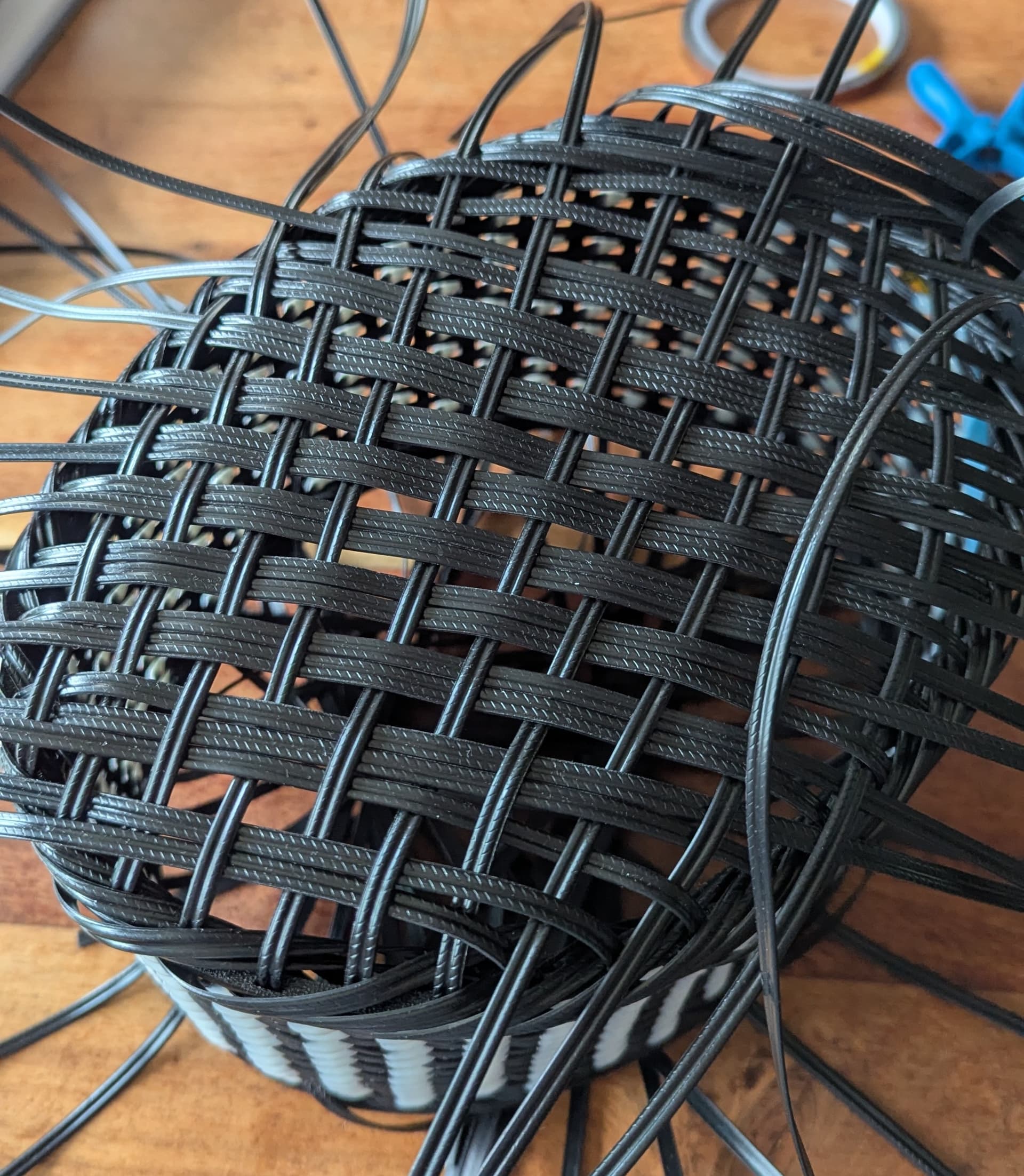

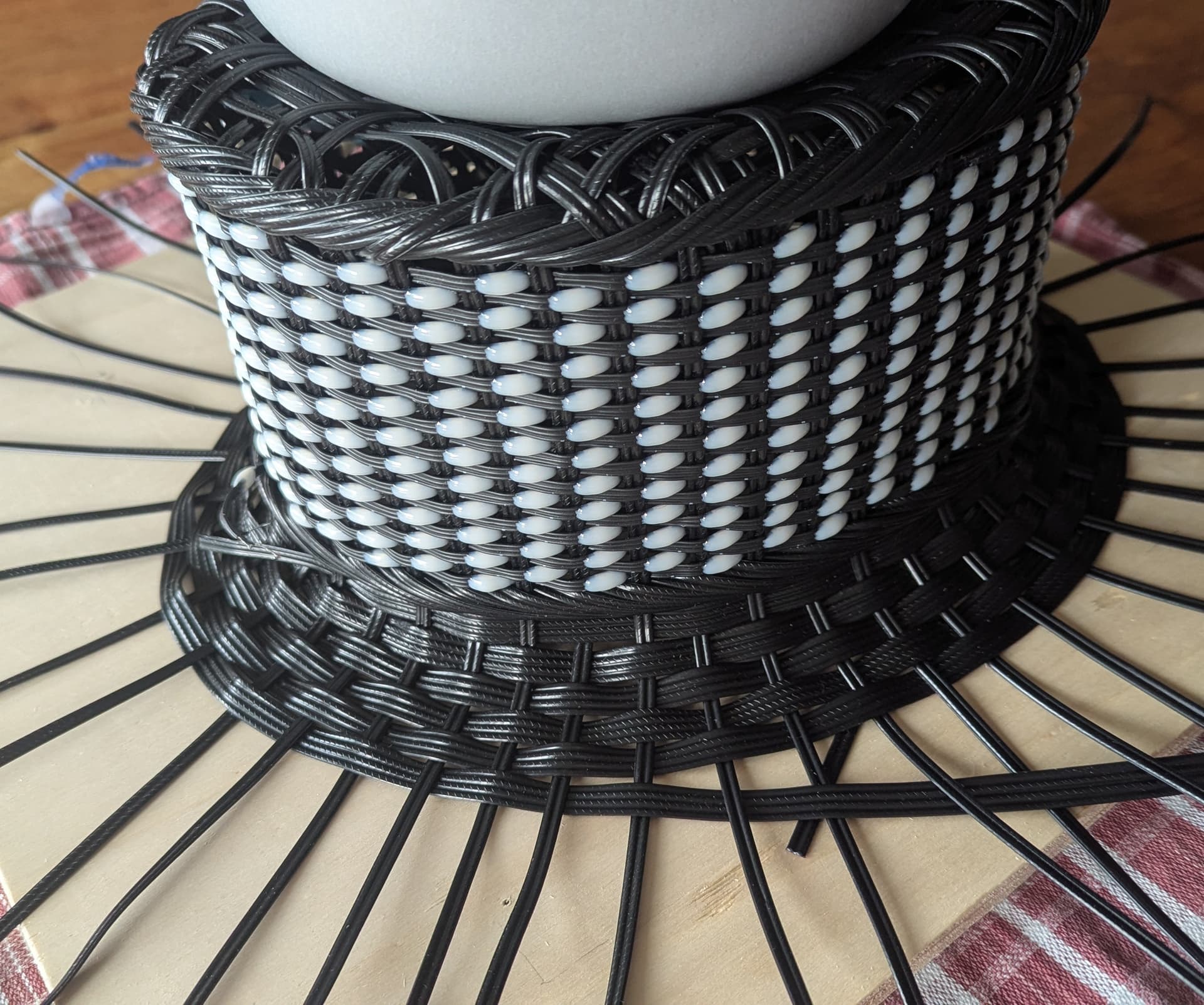

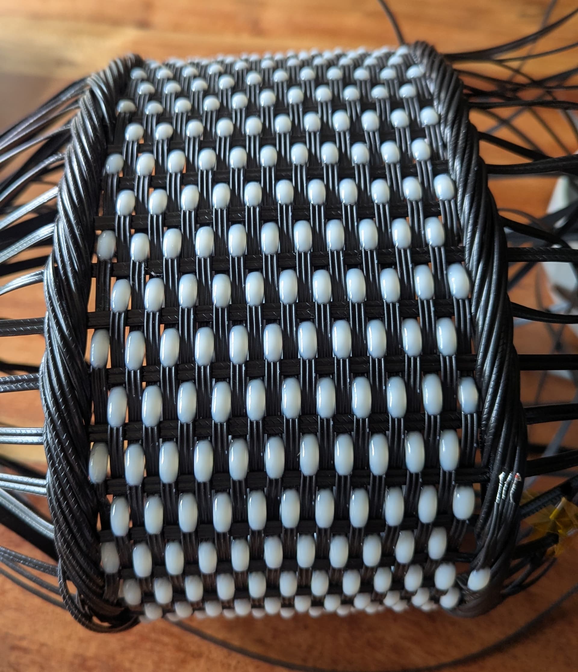

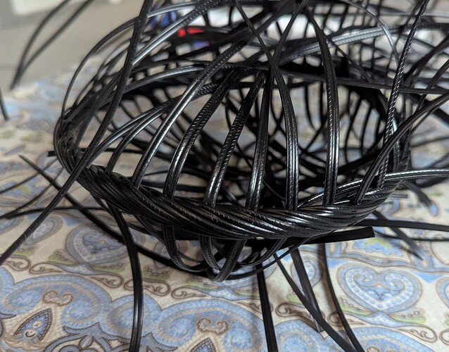

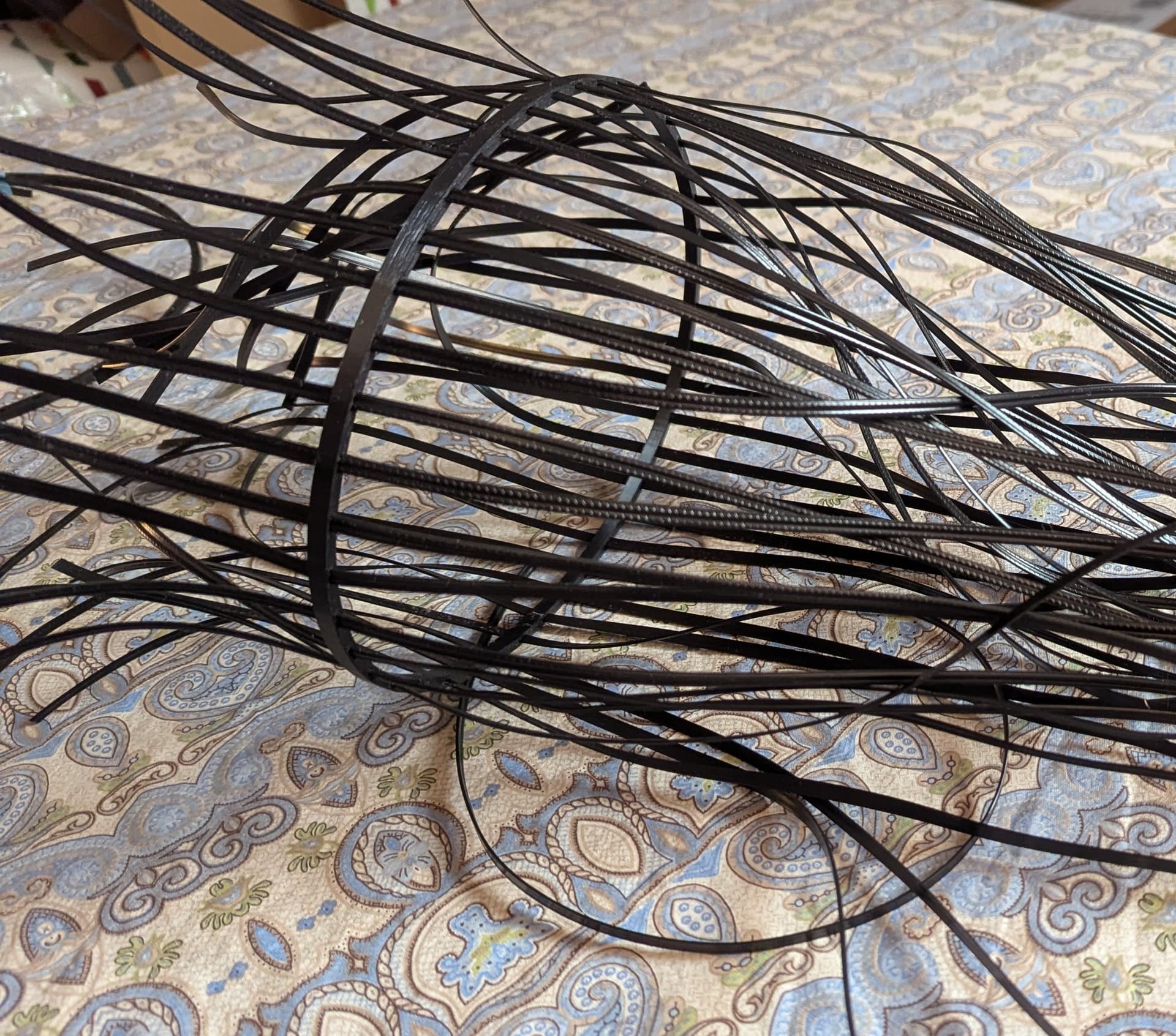

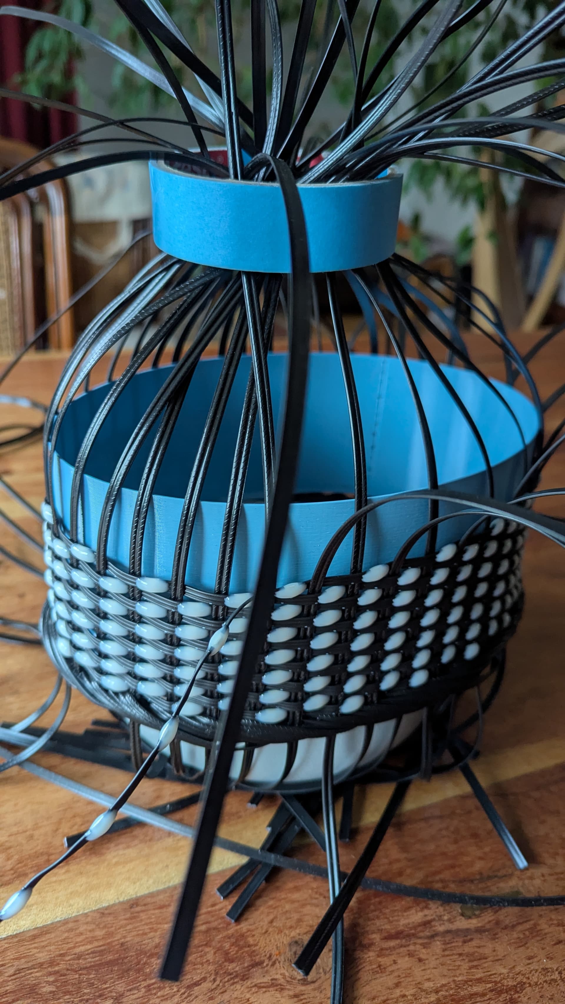

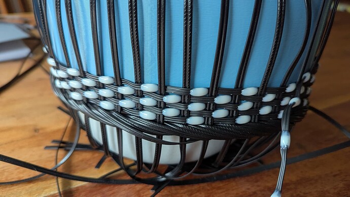

Here some pictures from the build process (Part1):

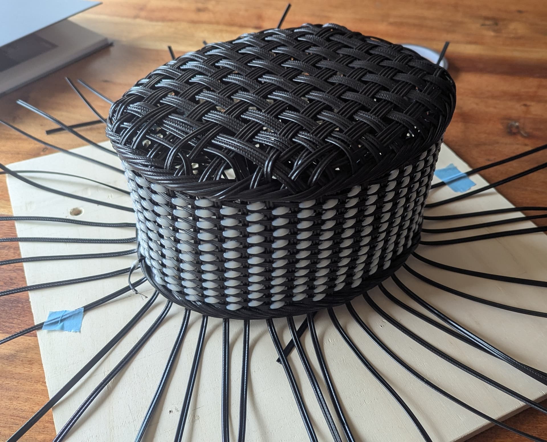

Part2:
I made a small test structure first, but then the proccess went quite well first try.

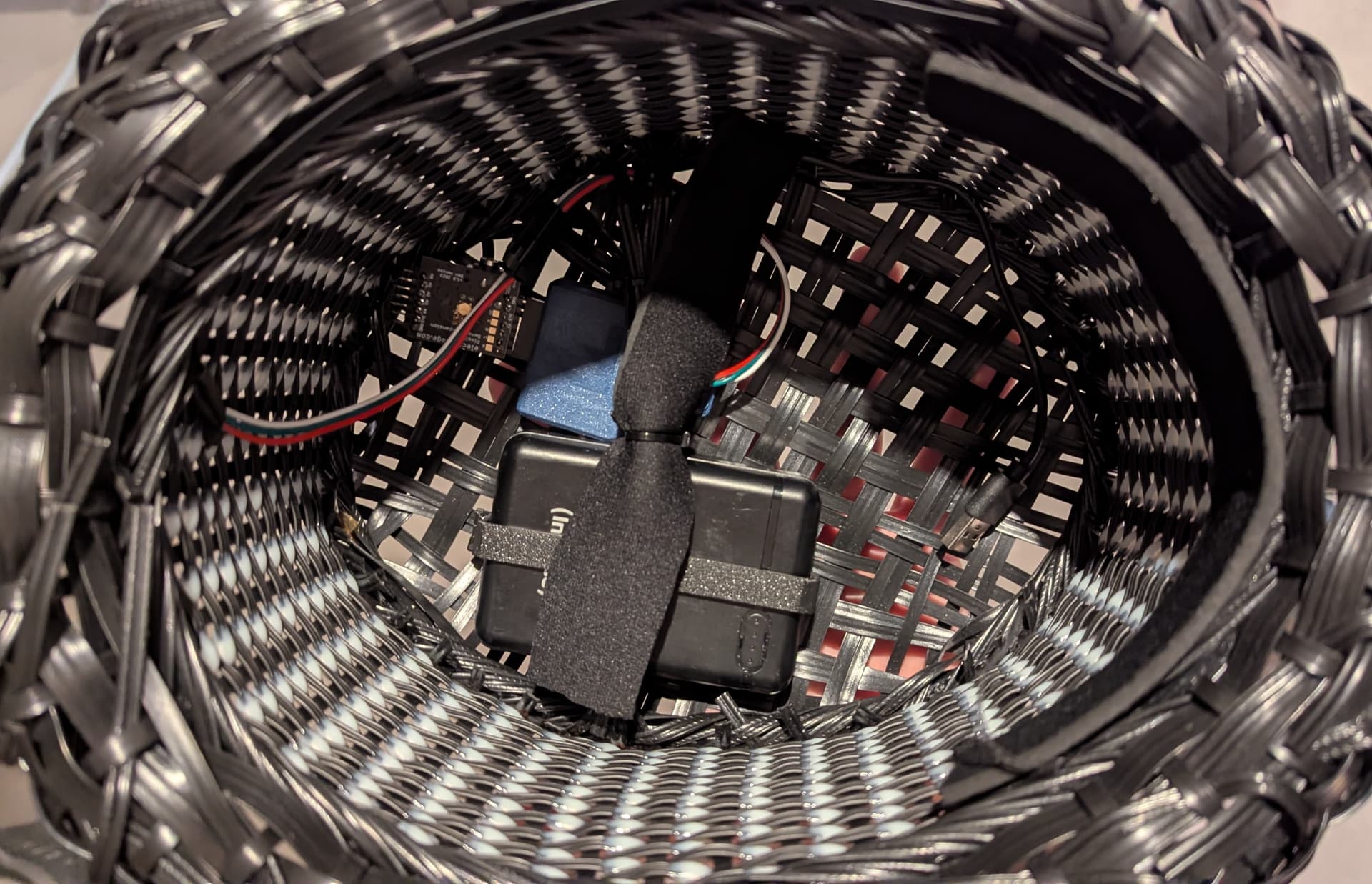

This is absolutely incredible – I didn’t even realize you COULD make a hat from scratch this way. Can you show a photo of the inside / where you mounted the battery and PixelBlaze? Really well done.
Thank you. I made a “cross-bar” out of rattan and fixated the Pixelblaze + sensor board and a powerbank with a 3D printed holder for easy swapping.
