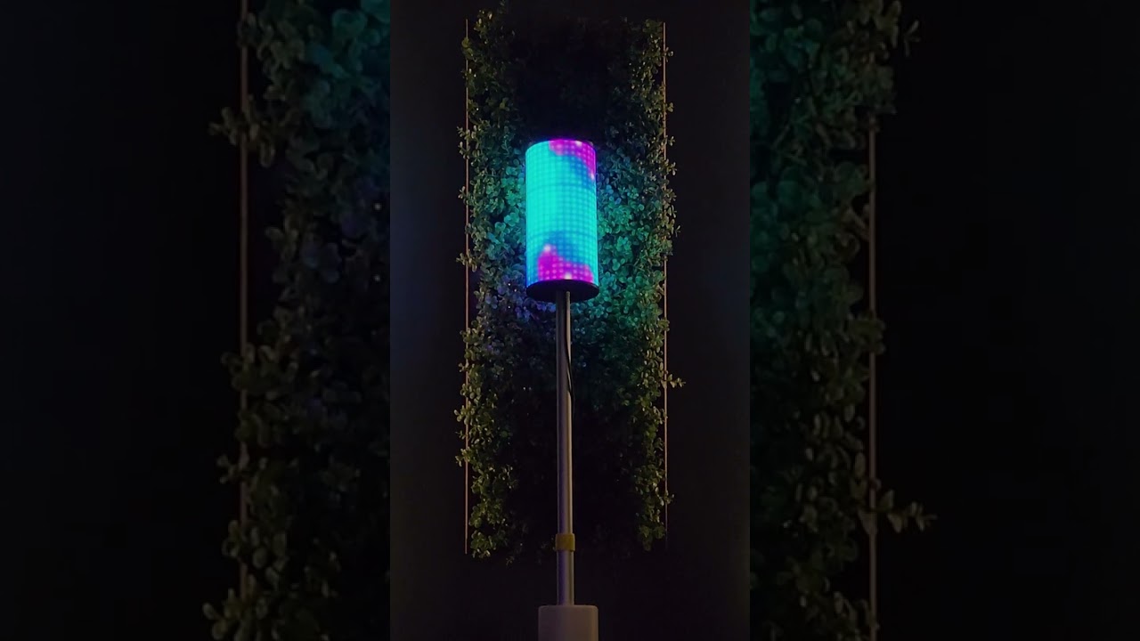

This is a totem I made for the Shambhala Music Festival this year. It’s 3 8x32 matrices stacked and wrapped to form a cylinder that’s 24 pixels high and 32 pixels around.
