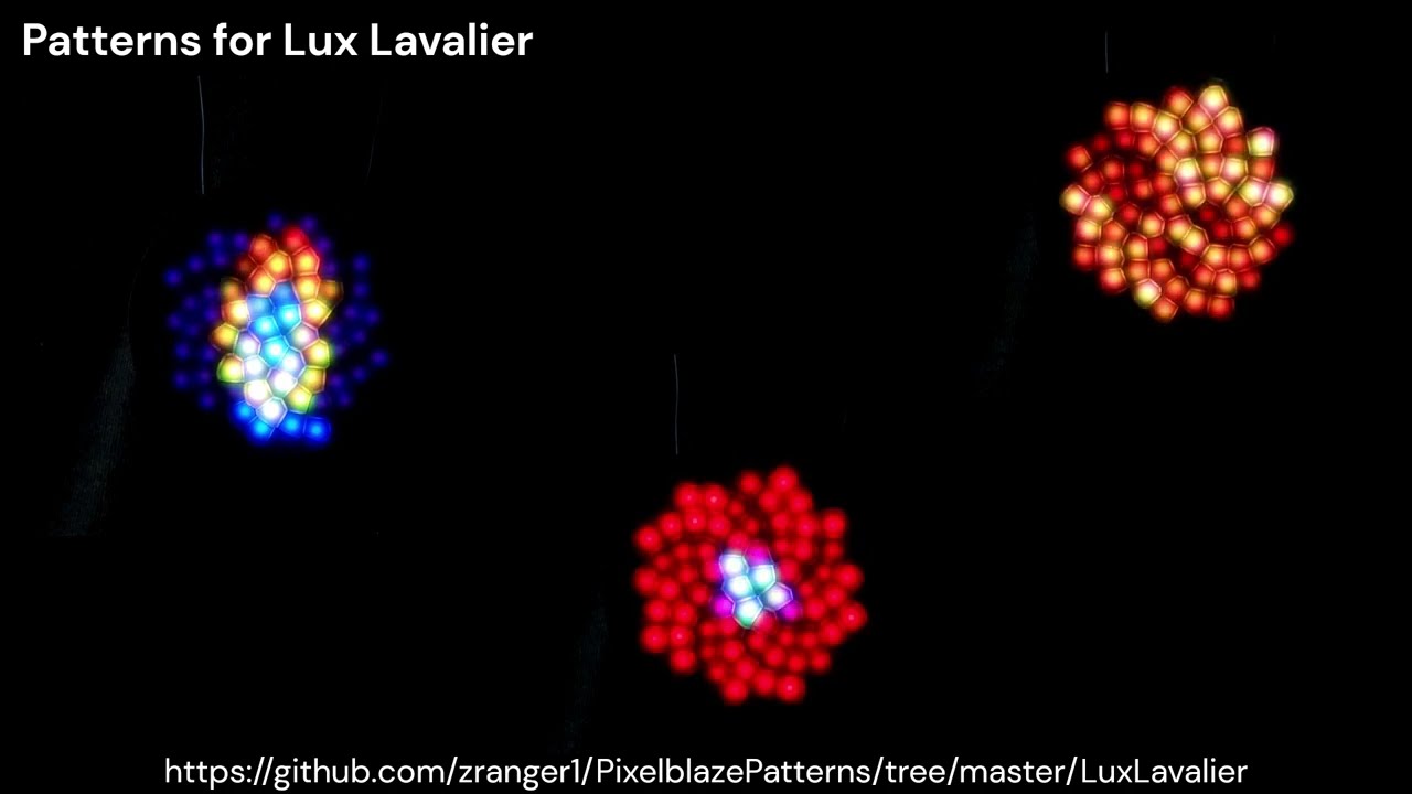

Here are a few new things I’ve done for the Lux Lavalier. (If you haven’t seen it, click the link and check out this fun, beautiful wearable art piece.)

Of course, they also work on any Pixelblaze with a 2D display. I’ve uploaded the first two to the pattern library, and source code is also available from my github repo.
