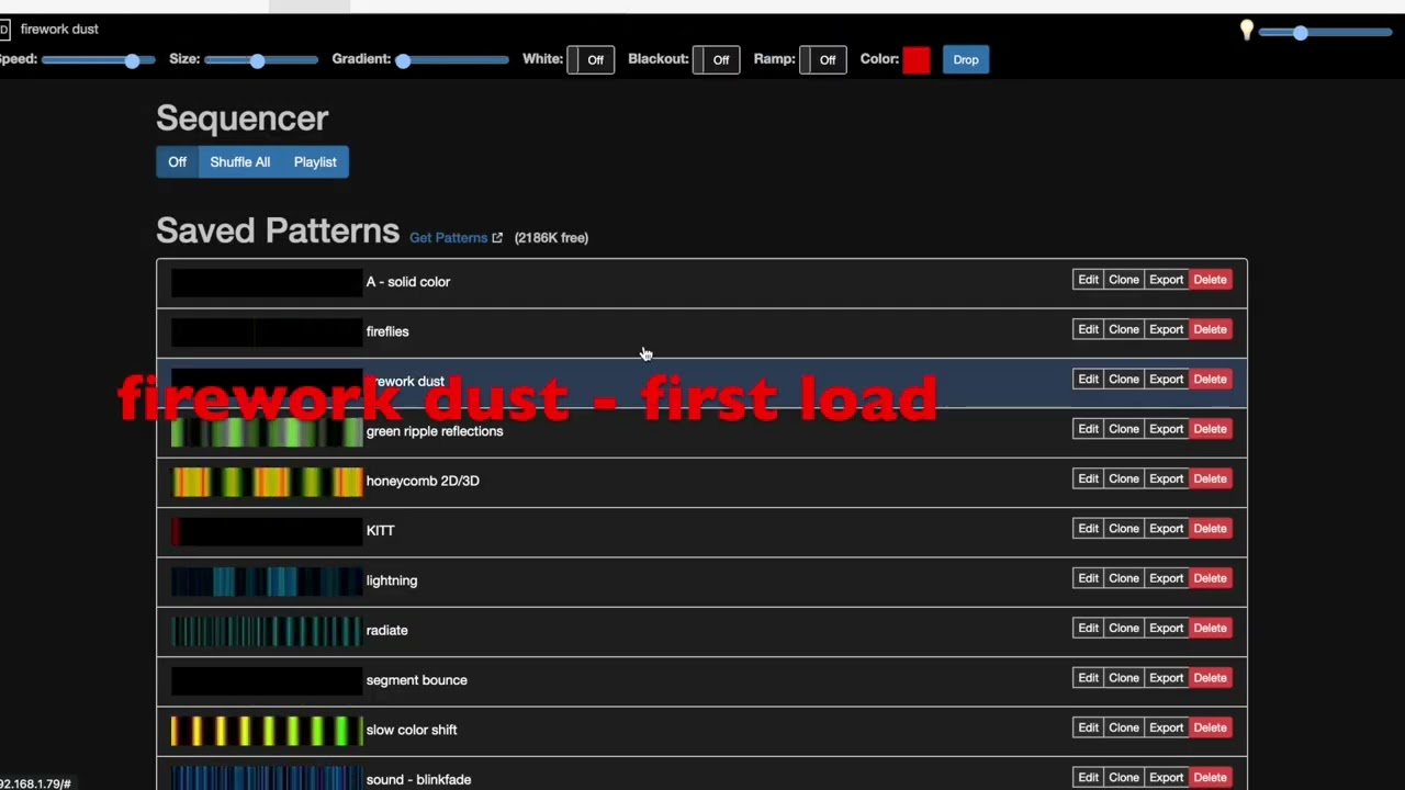

Thanks! Here is a video. It starts from a fresh boot after a week of use where no code changes were made.
For three patterns, the pattern is loaded on the Pattern tab, then the Edit tab is selected, the pattern is saved with no changes, then the Pattern tab is returned to. At this point the controls show as they did on the Edit tab, but selecting another pattern and then jumping back leaves them in a different order.
Regarding your question, yes. My expectation, or preference at least, would be that the controls for each pattern are in the order that they appear in the code, which is how they appear on the Edit tab. Currently I understand the ordering on the Pattern tab to be undefined or using some other logic.

Thanks for the details! Is it just me, or do some of the controls disappear? I’m guessing a bug snuck in there somewhere.
I noticed that in the recording not only changed order, but some of them were deleted. For example radiate first load shows a Random toggle, but this disappears in the editor.
I think one way of corrupting controls is if you are in the editor, and switch back to patterns and click on something, then back to the editor and hit save. This ends up clobbering the pattern’s controls with the wrong names, order, and values.
There also seems to be some other more nuanced issues just editing, perhaps some stale order information while editing similarly named controls.
In any event, in the videos from what I can see, it looks like clicking edit at least shows the correct controls names and order while editing. Let me know if that isn’t the case!
I have some fixes for these that should cover the nuanced corner cases, and will go out in the next update. Even if the saved controls JSON is weird, the names + order of controls should come from the pattern code names + order.
The issue when switching a pattern while editing is trickier, and it will clobber the controls data with something that doesn’t match. It should still load the right names and order though, and interacting with the controls will update the values properly.
