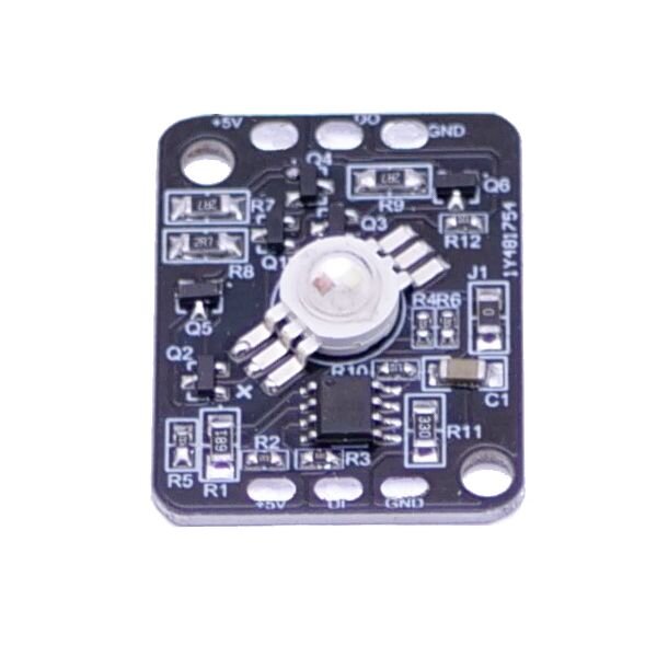

i did some online searches and this is what i could come up with. They are listed as ws28xx compatible so they should work with pixelblaze
https://www.ulrichradig.de/home/index.php/dmx/3watt-power-dot
