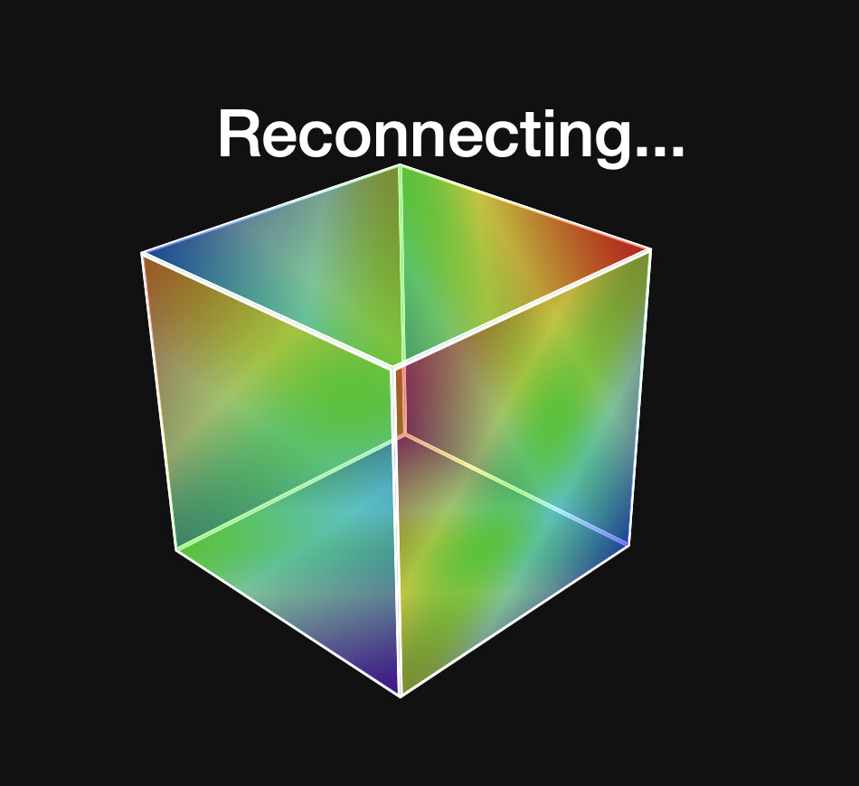

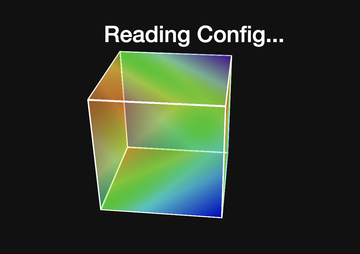

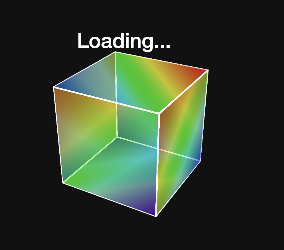

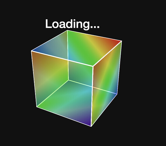

Recently all my pixelblaze v3 firmware v3.67.pb32 will not finish connecting whether in AP or Client mode. They just cycle through the images below and it will never connect.
I have tried via a MacBook pro, iPhone, iPad and I have tried multiple browsers.
everything used to work flawlessly, now nothing.

I also try to access the pixelblaze “web interface” @ 192.168.4.1. This is when I get the spinning cube of death. Pixelblaze will not progress past this point. Refreshing browser, clearing cache, private tab…Nothing Just Loading….Connecting….Reconnecting…..Reading Config… and this repeats.
