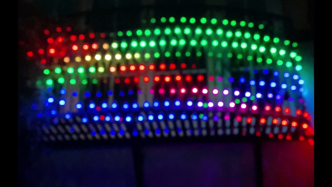

This is mine:
basePeriod = 1.2 / 65.535
export function beforeRender(delta) {
t1 = time(basePeriod)
t2 = time(basePeriod * 1.05)
t3 = time(basePeriod * 1.1)
export function render2D(index, x, y) {
x /= 2
y = 1.4 * y - .2
r = near(y, wave(x - t1))
g = near(y, wave(x - t2))
b = near(y, wave(x - t3))
rgb(r, g, b)
var halfwidthDefault = 0.4
// Returns 1 when a & b are proximate, 0 when they are more than `halfwidth`
// apart, and a gamma-corrected brightness for distances within `halfwidth`
function near(a, b, halfwidth) {
if (halfwidth == 0) halfwidth = halfwidthDefault
var v = clamp(1 - abs(a - b) / halfwidth, 0, 1)
return v * v * v
The advantage of a “near” in this case, when it comes to line/pixel drawing, is that the closer you get to the desired value, the brighter the value. (I’m doing something similar with line thickness in my wave pattern…)
The secret sauce is taking the difference between your actual value and desired value (using abs() removes the minus sign if any) and then using that difference, which if it’s zero (exact match) brightness should be 1 (or greater), and then the larger the difference, the dimmer the brightness should go … Toward zero (or lower). So subtracting the difference from 1 works well here.
Clamping and other neat tricks help to keep that value consistent, in the above near(), while my waves freely allows values to go higher or lower than 0…1 intentionally so that I can decide which wave to keep in front (the brighter one, but it’s set to only check half the brightness value, to have it switch a bit more)

That’s awesome. What are you using for pixels here?
I’m using a 10x30 net of WS2811s. It’s $220 shipped and IMO worth it for the labor savings of assembling one myself!
Ah ha, I was wondering how these work… Up close picture shows:
So basically take a few sets of bullets, add zipties. Yes, labor intensive but… Zipties are like $6-10 for 1000, and bullet strands are $12 for 50leds in bulk… So 300 led net is $12x6 = $72 + $8 in zipties… Or $80 in materials. So it comes down to your labor costs to zip up 300 zipties.
The $12-13 bullets (10 strands) might be 5V, though 12v aren’t much more. They have 3 inches of wire between them which seems low compared to the above… But it’ll make a tighter mesh then… Looking to see if longer wire lengths exist. I see some 4 inch lengths too
I’ve been trying to figure out how to make nearly anything you’d made work on my array for quite some time, but I cracked the code on this one!
I’m not entirely sure how to show this nicely on here, but this is the pattern I’m running. I just turned your render 2D into a render3D and played around a little bit in there and have gotten a pretty reliable interpretation of your pattern.
This is the first time with a PB that I tried to make something happen and the exact thing I wanted to happen happened! Very exciting.
