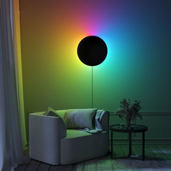

Take a strand (the size is up to you, but I’d recommend no bigger than 60), and tape it together, with the pixels facing outward. This way the light goes SIDEWAYS. You could also do it inward, but the effect is usually nicer outwardly. Your background matters, so try to do this on a white surface, or even if you can hang it up, a white wall.
Now, make a pattern that lights up the wall in neat ways. It could be as simple as a single line, like Task #17, or it could be much fancier.
Clocks are obvious, so let’s leave that. Make this more interesting!
Examples:
I really liked this idea a lot when you posted it, @scruffynerf, so I immediately added building one of those Etsy wall light things to my project list. Finally… finally, it reached the top of the list this weekend. (And the list still isn’t any smaller.) Here’s my circle of light – it is cool and fun and relatively easy to build. I highly recommend this project!
