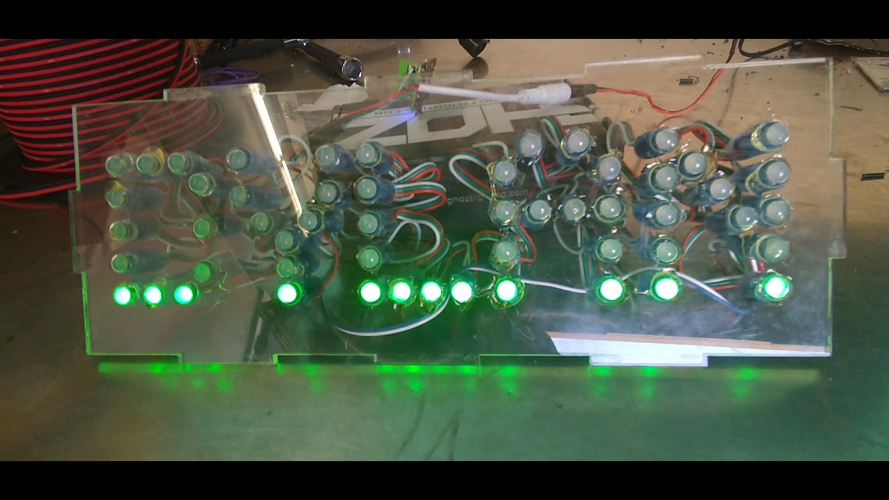

Hello guys. Sorry for the delay. This mapping is ok?
Just wanted to be sure you’re clicking on the image in the order that the pixels are wired, right? I am seeing some of the wires inside and wondering if you were marking them all, but not in their wiring order. For example, I couldn’t tell if a wire is directly connecting pixels numbered 14 and 15:

If you can post a video of the pattern Wizard included - Red-Green XY 2D Sweep.epe - that would be the most definitive answer as to whether it seems to be mapped correctly.
@jeff is right, you need to click on them in order. That should be listed clearly too on that page.
You need to start on the first pixel and click on them in order. Not just across the board, but the way the wiring goes. Otherwise it’ll be lighting up the wrong light and nothing will look right.
@jeff jeff Ok. I understand now. I was selecting the Leds wrong. I will try it again.
@Scruffynerf Ok. Thanks. I will try it again and post the results.
Good morning again everyone. It is working know. I was making the mapping wrong.
