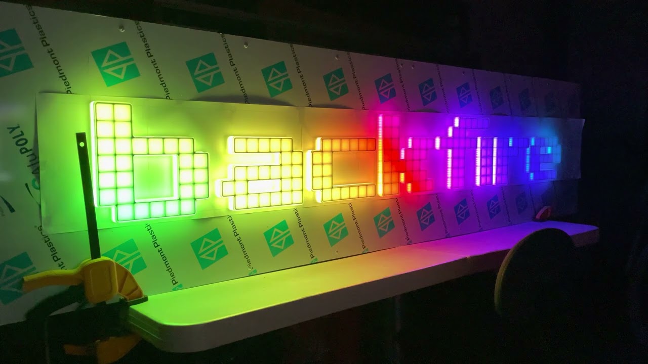

my camp Backfire is gonna be right across the street from you (and AEZ) at 3:45 and F. i’m also using a pixelblaze in our new-for-2022 camp sign. i was up all night getting the letters assembled and bolted in place. now to build the box frame and stand… its about 8 feet across and nobody’s gonna miss it at night.

Hi @timster did you custom-make those LED matrix modules that you are using? That’s a really awesome design!
thanks @PrismaticPhilo !
each “pixel” is a 4x4 led matrix. those can be ordered from aliexpress. but i had to design and build a jig that would let me lay out each letter with the correct spacing and hold the matrices very precisely in place while i soldered them together using header pins.
then it was a matter of designing the letter shells, determining the optimal distance from the LEDs to the transparent acrylic, etc. there’s a total of 2656 LEDs in the whole display. it was also a very happy concidence that the pro expander has eight ports which is exactly how many letters there are. :slight_smile:
Thanks for sharing more about your build! One of the hardest or at least most time-consuming parts of builds is soldering everything together. I might need to make a jig for some projects. it can be so hard to get things lined up perfectly. It turned out amazing and looks like it was well worth it.
Doing the math it looks like the modules you used are a little over 1.5" The LED modules look smaller than that. I found some 4x4 matrix aliexpress. I was actually thinking it might be something more like a 4x4 version of this. Which is such a small dense LED matrix. Adafruit DotStar High Density 8x8 Grid - 64 RGB LED Pixel Matrix : ID 3444 : $24.95 : Adafruit Industries, Unique & fun DIY electronics and kits
Can I ask what Acrylic you used? I have used the diffusing kind before with ok results, but I probably needed more distance between it and the LEDs.
You probably want something more like these 2x2 matrixes maybe?
