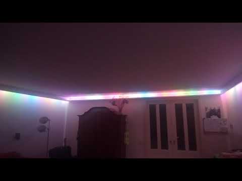

Yeah I figured that lol cool advertising is everything nowadays. It seems like the higher voltage is the bigger pixel is. I was trying to find how they will look on YouTube with no luck everything seems to be static there.
Found a good video on addressable leds, in terms of pixel sizes
So those cobs have 5cm pixel size that’s totally fine fo accent illumination of ceilling and etc. Its only a problem when you do some close patterns on the walls or something, with short viewing distance and if you want sharp picture.
