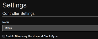

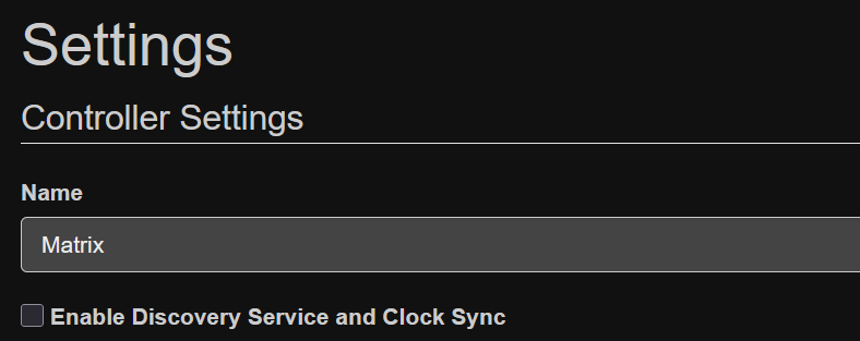

I’d guess that onboarding 40 students at once is going to be a little chaotic no matter what you do. To make getting everybody set up a little easier, here’s what I’d try:
  • when you have your students boot the Pixelblazes in AP mode to get the MAC address, also have them go to the “Settings” page in the WebUI and name their Pixelblaze something unique that they can recognize.
  • Then when they’re all on the campus wifi network, if you’ve got a computer on the same LAN segment that can run Python, install the pixelblaze-client library with pip, and run the short program below, which will list all the Pixelblazes currently on the LAN by IP address and name so you can know which student goes with which Pixelblaze.

Other things to be aware of:
Pixelblazes use broadcast UDP packets to do their synchronization magic. Per device, it’s not a lot of packets, and they use very little bandwidth. With 40 Pixelblazes on a highly managed and monitored campus network though, just the number of broadcast packets per second might make IT a little unhappy if they’re not expecting it.
If you can limit your traffic to a local subnet, great. If not, it might be worth bringing a cheap consumer router and setting up a separate WiFi network just for this purpose. It’s even fine if you can’t connect it to the internet. Pixelblazes don’t use internet access for anything other than downloading patterns from the library.

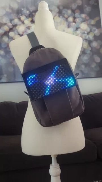

I wrote a couple of articles for Make: Magazine that use a Pixelblaze, and while they’re not beginner level builds, they may be helpful in coming up with ideas. The first article in particular has a fairly extensive section on getting started with the Pixelblaze:
Also, you mentioned getting started with motion/sound reactivity. Did you get the Pixelblaze Pico, or do you have sensor boards to go with the Pixelblaze standard?
I think I have a bit of the same perspective on LED animations that you do, having used CircuitPython and Pixelblaze extensively. If you’d like, I’d be happy to talk directly about my experiences with both.
