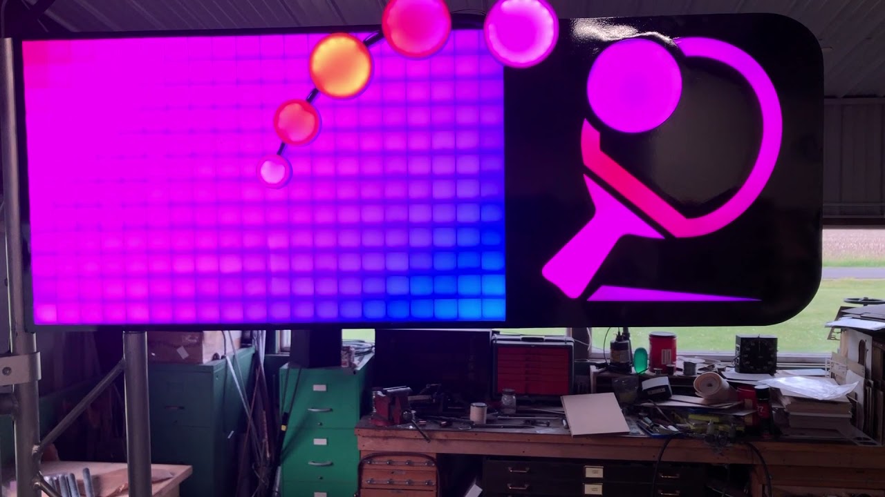

Been working on a sign the past few days for an upcoming trade show. Very pleased with PB and the animations, can’t wait to do some more animations for this thing! 694 pixels in all.
Inside the sign
Inside the sign

Here is a spread sheet of the map and a drawing with my chicken scratch notes.
Whew, nontrivial to map, some pieces (the grid) are pretty easy, some we can guesstimate since the photo shows us it’s an outline, and some (the balls) are complex (I don’t understand how 8 pixels becomes 30, for example).
We can hopefully use the photo mapper to do most of this though.

@Scruffynerf , the 8 to 30 pixels is because I split the data, there are 8 pixels along one half of the ball, this then continues to the next ball. but at the start of the 8 it is split and there are 7 pixels that go along the other half of the ball, but because there are balls on both sides of the sign the data splits before the first ball and goes to both sides. hope that makes sense.

Not really a map, I just used the standard 2d matrix and set it to 40 wide because thats whats in the main grid, so when a standard pattern is run the main grid looks good(but a little off center) and the rest of the pixels are just random. I didn’t mind that because it kept the ball somewhere else, where if they were maped to ther location the effect would be different.
Ok, let me give it back
Going via clock directions, starting at 12, we actually have two clock faces, back to back… One clock gets 12,11,10, to 6 with 8 pixels, then 7 going from 1,2,3,4,5,6 are a data fork, mirroring the left side. Then the other clock face is 15 pixels data forked as well. So it’s just 8 half moon, but functions as 2 full circles.
Correct! but entry point (12) varies with each ball, comes in along the arc in the pic
